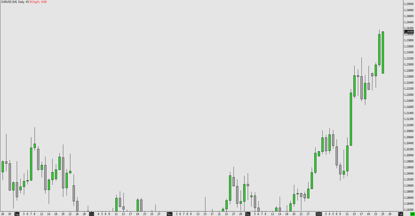

[2018-01-24 22:16:02]
jimskin - Posts: 127
A new daily bar has just been been printed (10pm GMT) on EURUSD. I have included a screenshot below. I tried the Reload and Recalculate and the Delete All Data And Download options but nothing happens.
http://www.sierrachart.com/image.php?Image=1516831845150.png
[2018-01-25 00:08:54]
No you do not need to enable that option.
The problem is the new bar is starting right before the time that the Daily High and Low are being reset. So just before they are being reset. So it does make sense that you see what you are.
We are working on a solution which should be out by morning or by Monday.
Date Time Of Last Edit: 2018-01-25 00:09:47

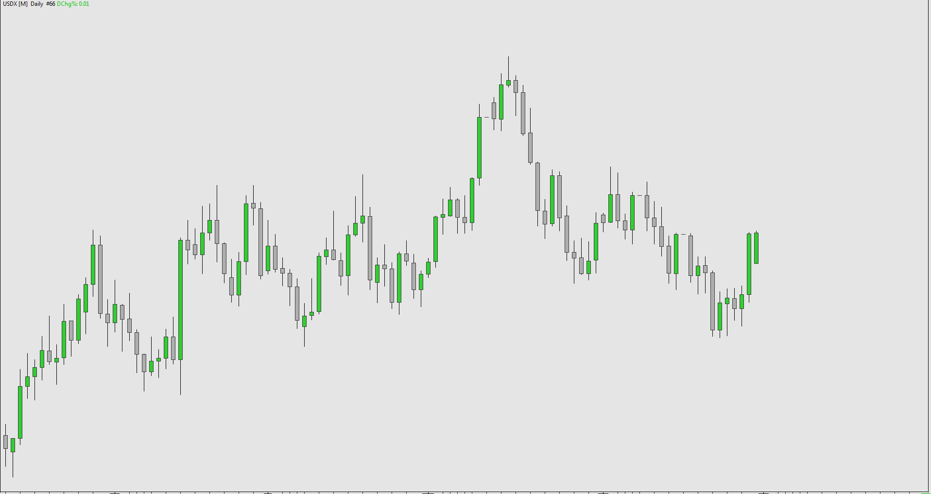

[2018-09-27 22:23:43]
This issue still seems to be happening in v1799 (64bit). Here's a USDX daily chart. The daily bar has just formed.
http://www.sierrachart.com/image.php?Image=1538086866487.png
[2018-09-28 02:32:17]
It is not totally clear what the issue you are trying to show us is, but we do realize that we have to control when a new daily bar is created and that needs to be at 5 PM US Eastern time. This has now been set up.

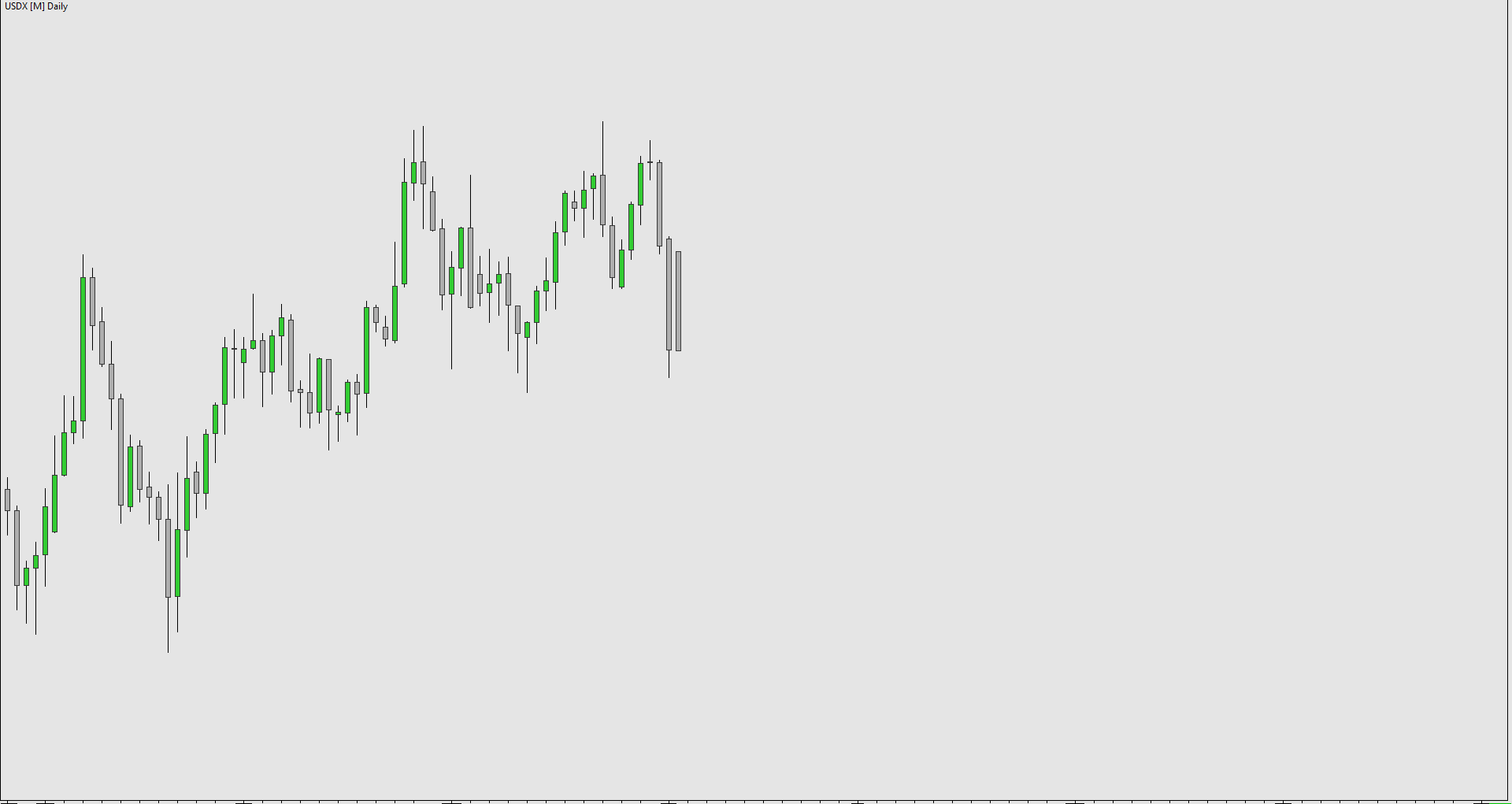

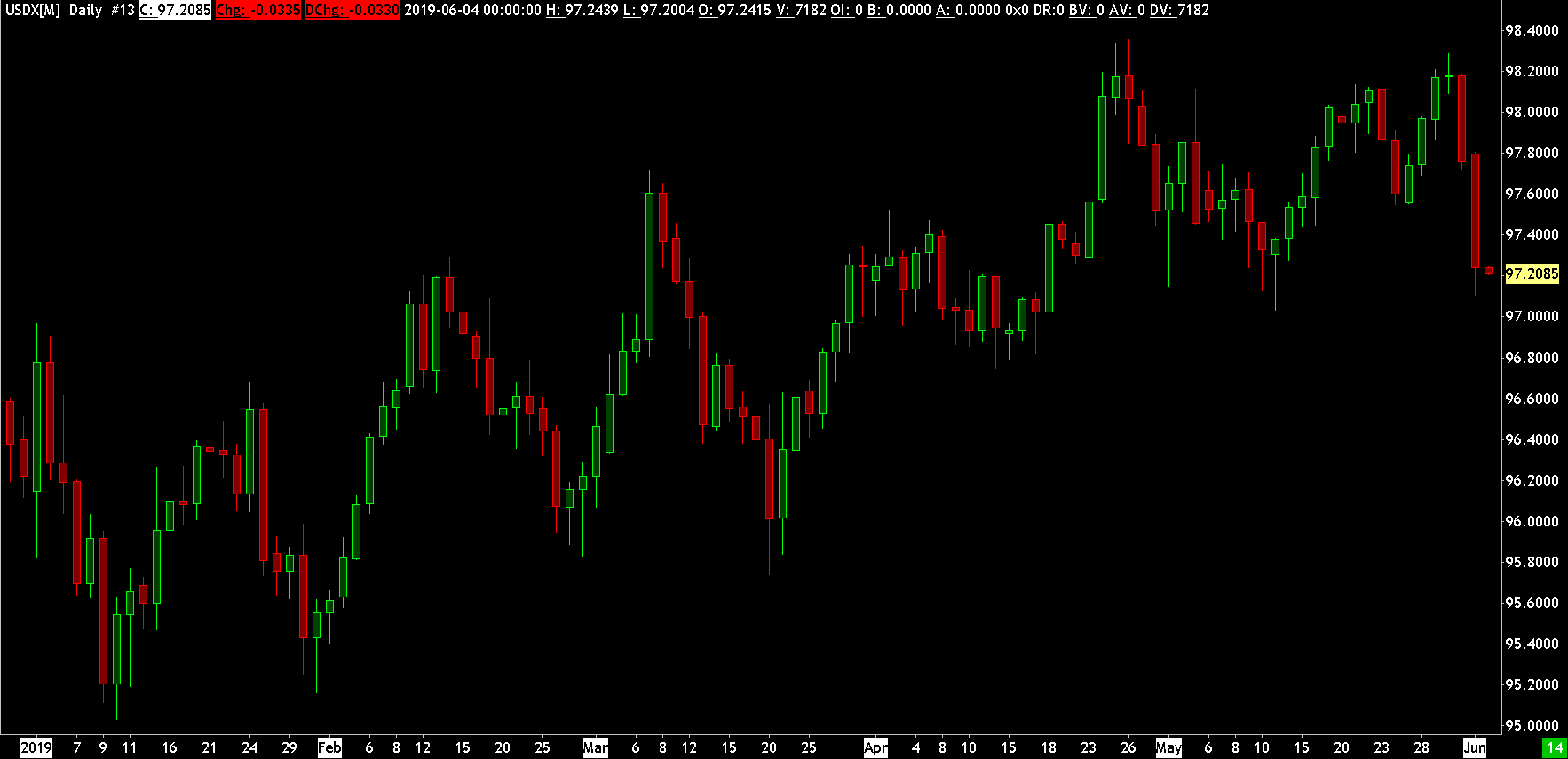

[2019-06-03 21:06:58]
Here you go. This daily bar has just opened on USDX.
http://www.sierrachart.com/image.php?Image=1559595876759.png
[2019-06-03 23:08:26]
We have been unable to reproduce the issue and we think the problem relates to the time zone setting you have in the chart and/or the Global Symbol Settings. Set these charts to the New York Time Zone as explained here:
Time Zone Setting: Using Different Time Zone in Individual Charts
Also, we did make a small change in the program related to the timing of starting up a new Daily chart bar. So update to the current version:
And do not alter the Global Symbol Settings for these symbols you are having a problem with related to the session times. If you do, this will cause the problem.
Also we do not see what you do in the chart image. This is what we see:
http://www.sierrachart.com/image.php?Image=155960254591.png
Date Time Of Last Edit: 2019-06-03 23:09:03
