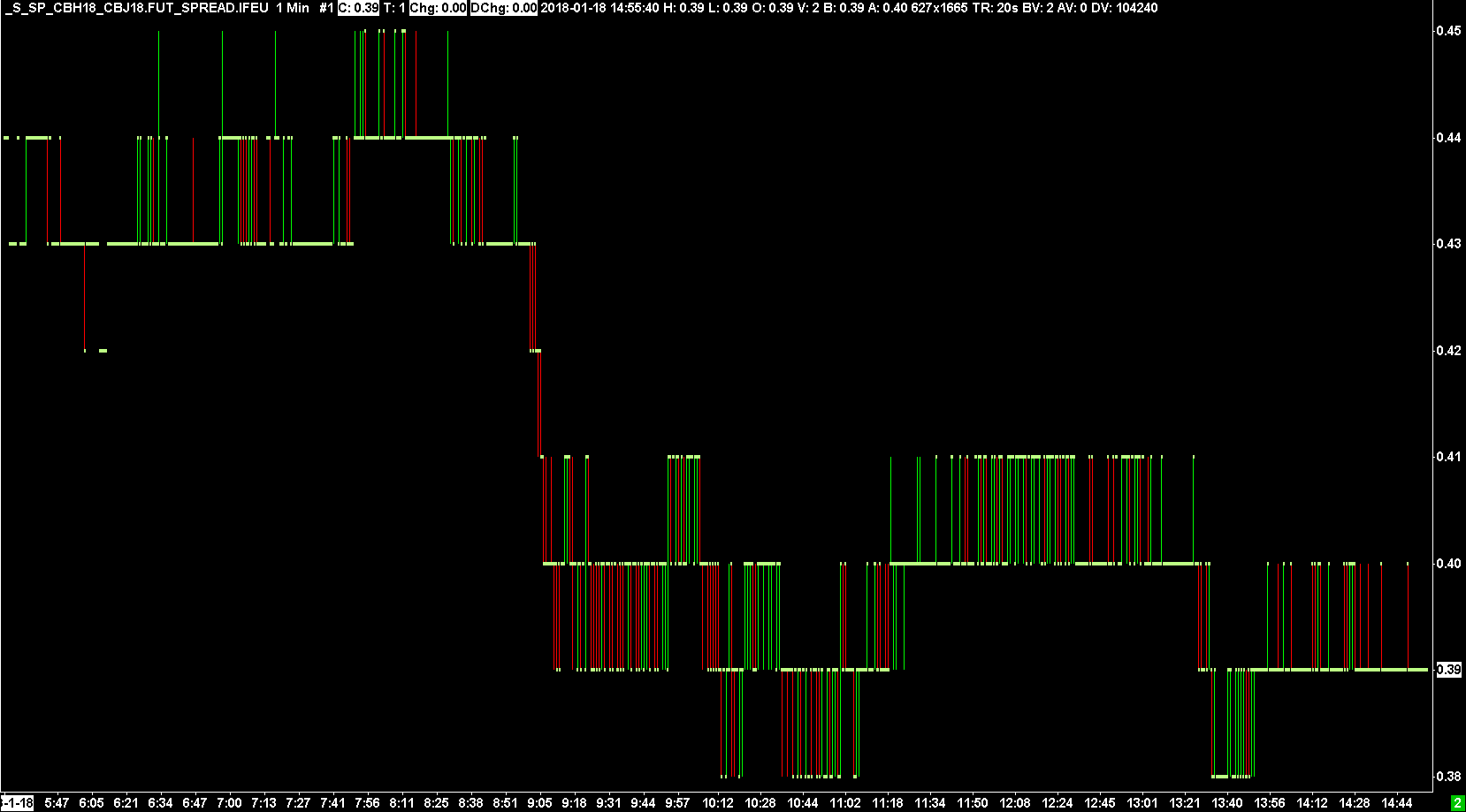

[2018-01-18 13:23:25]
User428493 - Posts: 20
http://www.sierrachart.com/image.php?Image=1516279018231.png
As you can see CBH18 last value is 69.39 at 12:36, CBJ18 is 68.95 at 12:36. Spread must be 0.44 at 12:36, but the real value is 0.43 at 12:25 and no data for later time. While I made the post, its 13:25 now and the last spread value is still 0.43 at 12:25.

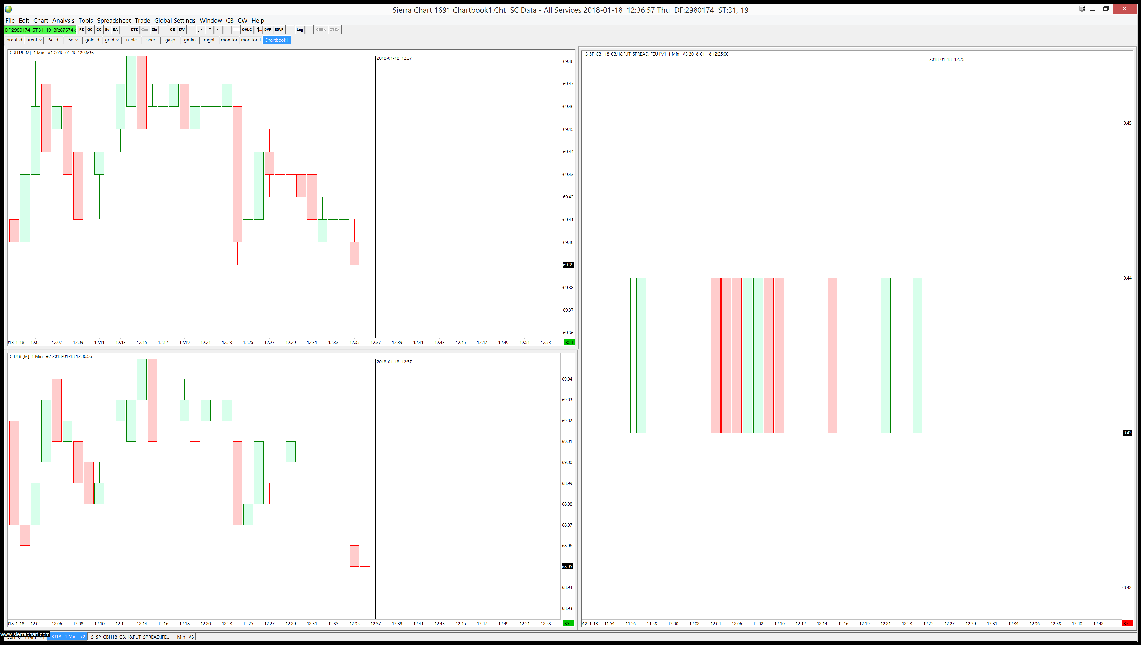

[2018-01-18 19:56:53]
This is because the chart is not scrolled to the end. Scroll the chart to the very end.
This is what we see at this time:
http://www.sierrachart.com/image.php?Image=1516305373644.png
As far as a different you see, you really need to ask the exchange about that. That is not something we can answer ourselves.
[2018-01-18 20:09:07]
Right. It's not a permanent problem. Just checked - now the spreads show correct data. But in several hours it may be incorrect again. For some reason spreads stop updating for some time (1-2-3 hours) and then the problem disapperes. A week ago is the first time I got this problem, never noticed before (I'm using spreads charts every day).
