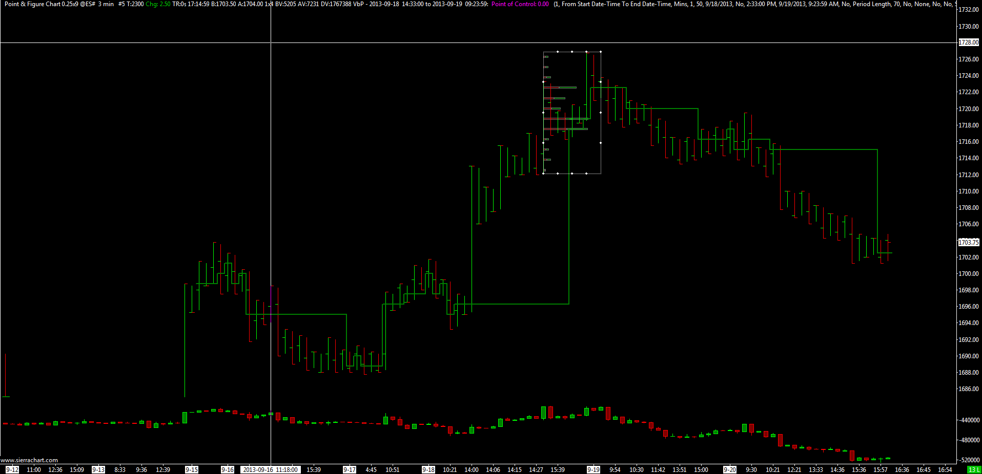

http://www.sierrachart.com/image.php?l=1379792887770.png
Images
A bar every 5 ticks with setting at 1.

pismo10 - Posts: 171
Image of settings. "Edit Attached Files" does nothing so..
