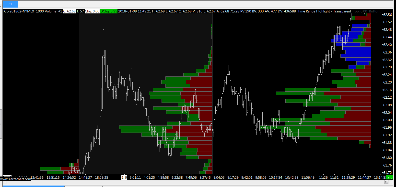

Hi, I just started my free trial for SC and I am just trying to set up all the amazing functionalities that are available.
I am starting with the Volume by Price.
Please find here the picture of the Volume by Price study that I did on my CL chart, is a 1000 volume bars chart
http://www.sierrachart.com/image.php?Image=1515516565184.png

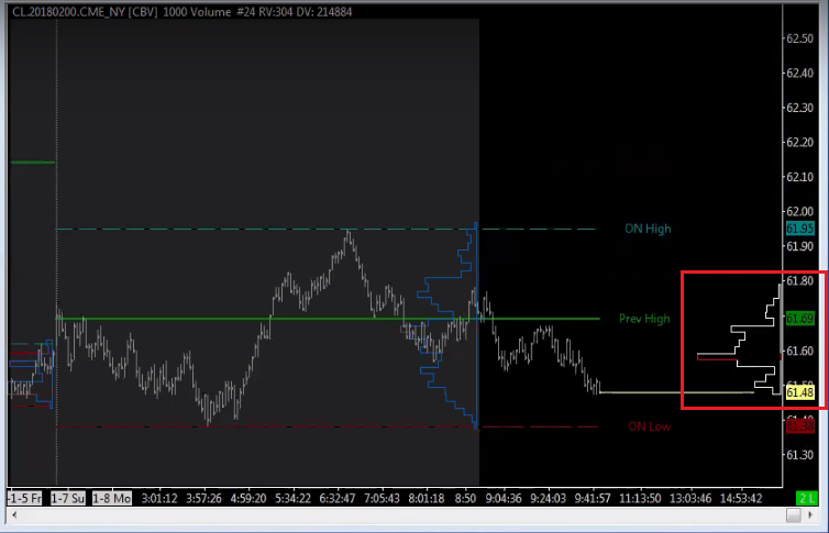

I would like to setup my volume by price study as shown in the attached picture "vbp_tobe.png" in the red box.
This is a volume profile very minimal which is showing the high volume areas without overlapping the price action.
Thank you in advance for you kind help
As you can see the picture shows 2 volume profiles, one for the overnight session and one for the regular session.
Additionally as you can see from the picture the volume profile is not overlapping the price chart. Also as shown in the picture the volume profile in its maximum lenght is not taking all the space of the window
imagevbp_tobe.png / V - Attached On 2018-01-09 20:21:22 UTC - Size: 126.48 KB - 566 views

The settings for the Day session can be found here:
Volume By Price Study: One Volume Profile at End for Day Session
The settings for the Evening Session can be found here:
Volume By Price Study: One Volume Profile at End for Evening Session
[2018-01-12 14:04:37]
In addition to the above links the procedure is to first follow the Step By Step Instructions:
Volume By Price Study: Step By Step Instructions
to add the Volume by Price study to the chart and then modify the Input settings of that Volume by Price study instance to what is described in the subsections linked to in the prior post.
