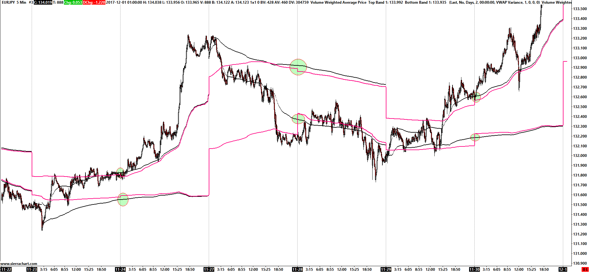

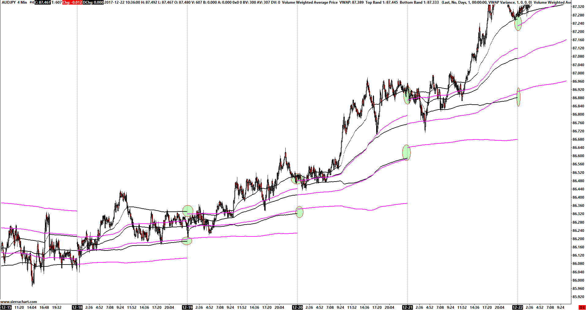

Hello. I want to view every day's continuation of the previous day's VWAP.
This is achieved by using a 1 day VWAP study and a 2 day VWAP rolling. (with time period type Days - Trading days and Number of Days to calculate -100) (I am not interested in candle by candle rolling.)
The rolling VWAP line is correct but the rolling first standard deviation lines of the second day are wrong.
I have attached a file to show what I mean. Black is the normal VWAP and Pink is the 2 day rolling one.
I have tested using a normal 2 day VWAP and the 1 SDev lines are correct but obviously I am missing 50% of the days so this is not an option for me.
Regards
imageAUDJPY 4 Min #4 2018-01-07 07_04_52.005.png / V - Attached On 2018-01-07 05:20:40 UTC - Size: 96.31 KB - 856 views

We are quite confident the calculations are correct if you go through the formulas documented here and manually verify this by doing the calculations manually in relation to the data:
Volume Weighted Average Price (VWAP) - Rolling with Standard Deviation Lines
We are running a test though to verify that. Allow about a week or two.

User995923 - Posts: 64
I attached 2 charts comparing the STDEV of the 2day normal VWAP study with the SDEV of the rolling 2day study (option: trading days)
The results are too different to the point I cannot trust the SDEV bands of the rolling indicator.
Maybe you are missing a minor detail?
imageETHUSD-BITFINEX 5 Min #3 2018-01-09 18_45_24.613.png / V - Attached On 2018-01-09 16:50:04 UTC - Size: 104.67 KB - 545 views
