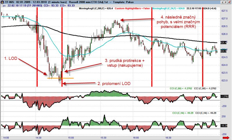

trade2day1: it says the code. cci50 cross from bellow -100 and cci14 cros from bellow 0 tomgilb: thank you it works!! do you have please any idea how it also drive for example vertical line when this hapaned? and also, would be possible to see vertical lines every single signal in past when this hapened? pls, see the pic. http://www.financnik.cz/images/pattern0_100long_podrobneji_2.jpg |

Add the Color Bar Based On Alert Condition study, put the formula in its Alert tab instead, set the Draw Style to Background. There is also a way to do a vertical line, if that's what you'd prefer. |

yip, it works but i would prefer vertcal line. the color bar based on alert condition works not that well. i gotta say i have not foun vertical line study where i coul make this formula work. thx for your patience |

if you use Color Background Based on Alert Condition there is a vertical line option
