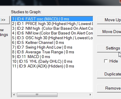

[2017-12-17 20:33:59]
EuropeanTrader - Posts: 290
http://www.sierrachart.com/image.php?Image=1513542728442.png
see attached.
Yes, color bar with alerts, separate for highs:
=AND(H > ID1.SG1 , H > ID5.SG2 , ID4.SG1 > ID3.SG1)
and lows:
=AND(L < ID1.SG2 , L < ID5.SG3 , ID4.SG1 < ID3.SG2)
imageScreenHunter 892.jpg / V - Attached On 2017-12-17 20:33:55 UTC - Size: 78.95 KB - 487 views
