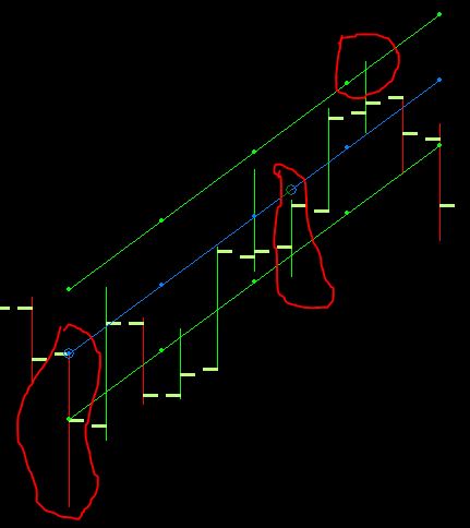

Marmany - Posts: 319
Linear regression is statistically the wrong tool to analyse a sample size of less than 6 (also the channel angle becomes over dependent on price movement in last bar) you really need at least 11 bars. A moving average has far more validity when length less than 6.
Over small bar ranges you really need to dig into intrabar price action to appreciate what the market is up to.

[2017-12-12 16:28:26]
User99934 - Posts: 227
Here is a sample of linear regression of highs projecting high just a few minutes ago. How would you do it with a moving average that you like?
