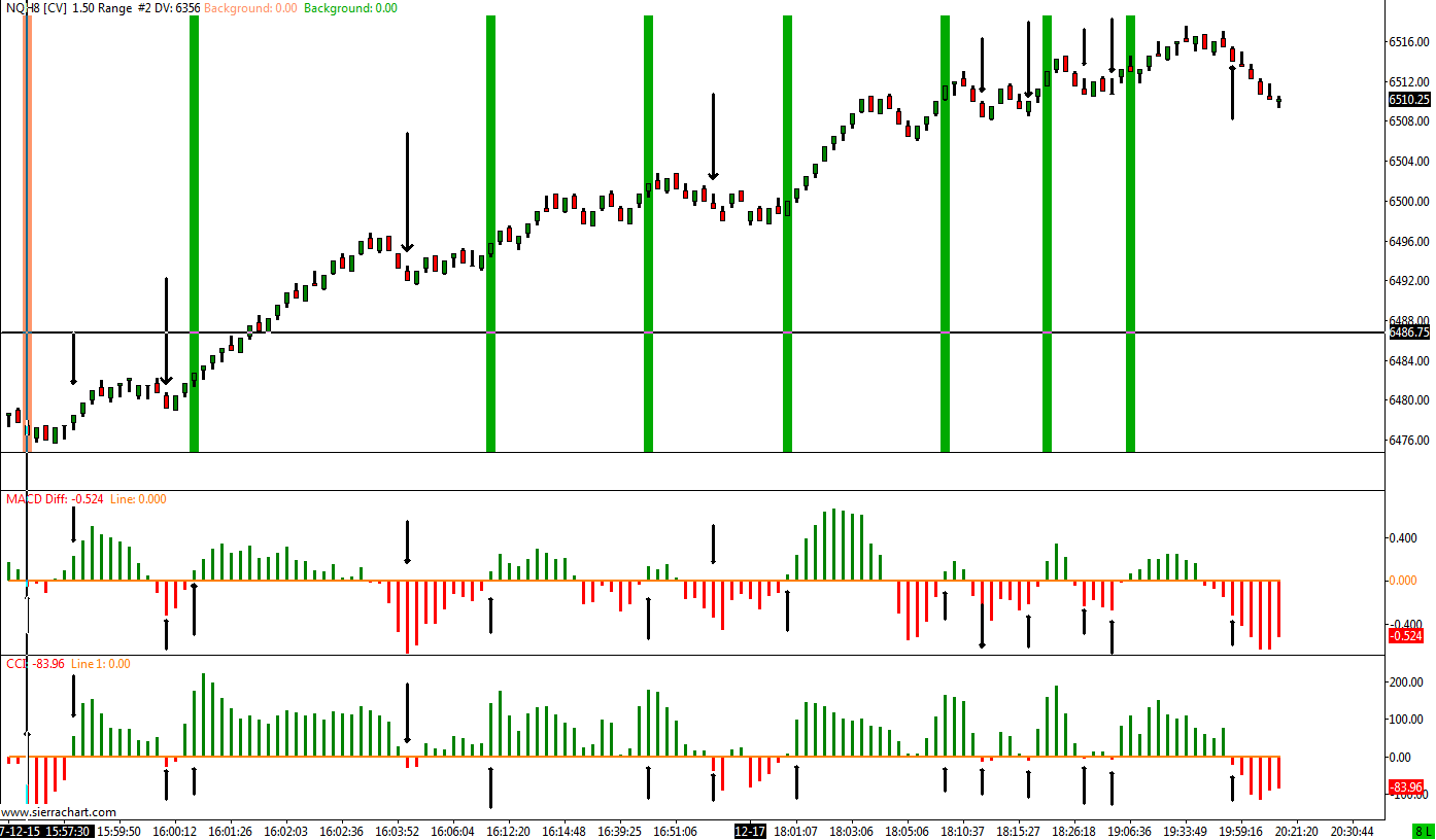

http://www.sierrachart.com/image.php?Image=1513560101525.png
I have written two codes, one for shorts and one for longs.
AND(CROSSFROMABOVE(ID2.SG3,0),ID3.SG1<ID3.SG2)
AND(CROSSFROMBELOW(ID2.SG3,0),ID3.SG1>ID3.SG2)
The Chart you are viewing is a "NQ" 7 Rangebar chart with a MACD indicator and a CCI indicator. As you can see sometimes I get an orange background color when it indicates a short setup and sometimes a green background color when it indicates to go long. Everywhere you see an arrow is where it should be indicating a long set up or a short setup. Those arrow are pointing out the first time they are both above or below the zero line on the two indicators.
I want to know the first time they are both in confluence. I want the color background to trigger as the moment unfolds. Like a warning signal. Then once it meets the criteria then as you can see it should just stay highlighted. I only need that bar to be highlighted.
I hope this makes sense. I appreciate the help or direct me to a person who you think can make it happen. Gregg

[2017-12-18 22:55:59]
Sawtooth - Posts: 4361
Try this:
Longs:
OR(AND(CROSSFROMBELOW(ID3.SG3,0),ID2.SG1>0),AND(CROSSFROMBELOW(ID2.SG1,0),ID3.SG3>0))
Shorts:
OR(AND(CROSSFROMABOVE(ID3.SG3,0),ID2.SG1<0),AND(CROSSFROMABOVE(ID2.SG1,0),ID3.SG3<0))
where the MACD is ID3 and the CCI is ID2.
