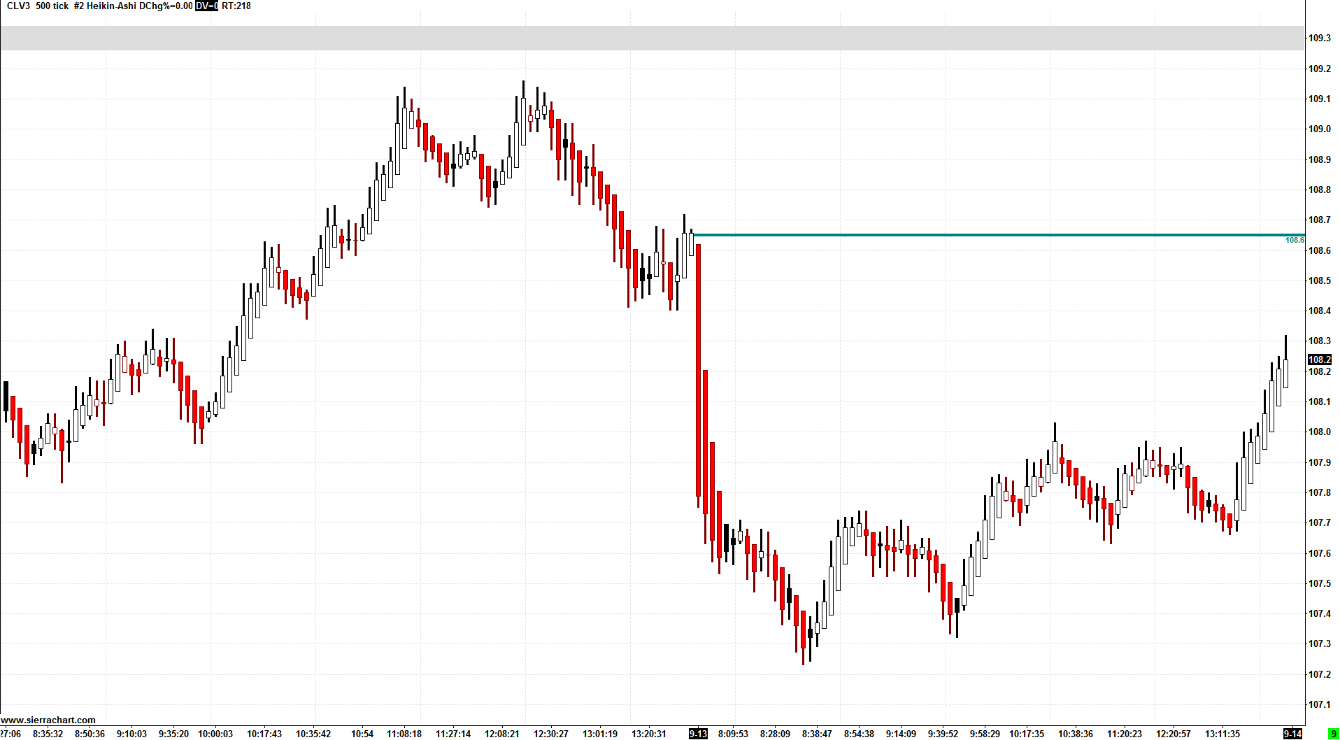

madra - Posts: 109
Hello Team,
I have the identical request which was posted by Max August 1, 2013 (post 395)
Heikin Ashi: hollow green and red bars when going up solid green and red bars when going down.
I believe that there is a charge for this enhancement which I am willing to pay.
Thank you,
Madra
[2013-09-14 21:43:17]
M5amhan - Posts: 468
"going up" and "going down" is going to have to be defined
[2013-09-15 01:24:12]
madra - Posts: 109
Hello Trade2Day1
Here is a youtube video of what I want. I hope you can open it. Heikin Ashi by Manny Backus July 2012
www.youtube.com/watch?v=wFcpTVu-F8U‎
1. Hollow candle sticks which indicate an uptrend (green/red)
2. Filled candle sticks which indicate a down trend(green/red)
Max posted a similar request on August 1, 2013.(post 395) He also attached a chart which gives an example of what is required. He was able to achieve what he wanted with the green candle sticks but not with the red.
Hope this is enough information.
Thank you,
Madra
[2013-09-15 02:55:05]
i made a chart here that looks exactly like the one in the video you just gave me
http://www.sierrachart.com/image.php?l=1379213651410.png
edit: you may be able to see more clearly in this one (you can change the colors as you please) -- http://www.sierrachart.com/image.php?l=1379213776766.png
it is also attached.. is this what you are trying to do?

1) add heikin-ashi study and select "display as main price graph" on the left column.. set the colors as you please. for hollow up bars, color the row labeled High the same as your chart's background
2) add color bar based on alert condition study and put this into the alert tab =AND(C<C[-1],C>O) what this does is when a heikin-ashi candle closes below the previous candle but is still an up candle, it colors the outline your selected color.. also set the draw style to "color bar hollow"
3) add another color bar based on alert condition and put this into the alert tab =AND(C>C[-1],C<O) when the bar closes above the previous bar but is still a down close this will color the bar your selected color. leave the draw style as "color bar"
