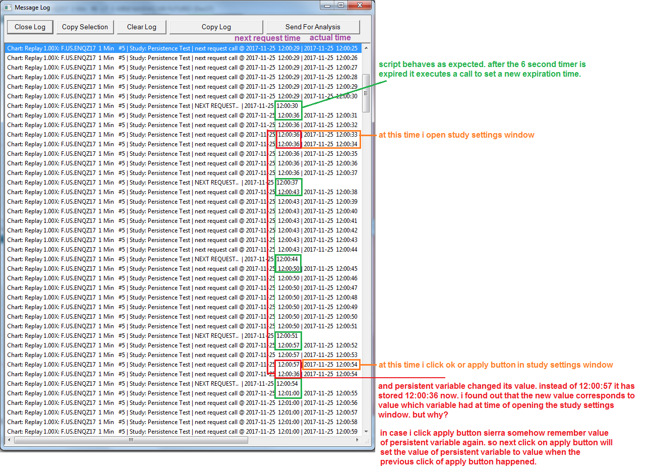

during the development of study i encountered a strange behaviour of my script. index of array stored in persistent variable changed its value to incorrect value unexpectedly. so i could not delete all graphic objects because the index was wrong and some objects remained on chart.
i could not replicate it because i did not know what the trigger is. until yesterday. for sake of simplicity i created an example of code which causes the issue. please see attached picture for explanation.
i think this behaviour affects all persistent variables and changes their values. is this a feature or some kind of bug?

imagep_test_img.png / V - Attached On 2017-11-25 18:54:39 UTC - Size: 215.27 KB - 606 views

We understand the nature of the problem. This is involved to resolve but we will see if we can get it done today.
Hopefully there are no unintended consequences with the solution.

This is now confirmed to be resolved. We will have a new release out later today.
