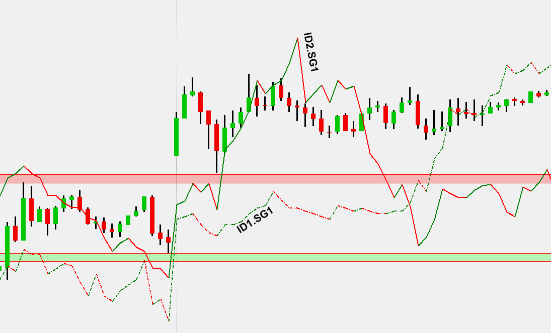

I use two different studies, as shown in the pic. If both are going in the same direction, the background within the studies should be red or green .
Unfortunately, I do not have any idea how to implement this.
I would be very happy about suggestions.
Many Thanks

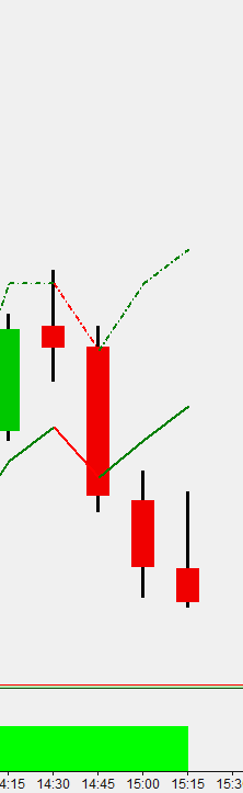

I saved and start it as you said. I placed it in Region 2 but there is only one color ==>> blue.
I used the correct studies (in my case ID 18 + ID19).
Yon, is it possible to take a look on it?
Maybe you have to know that one studies is an "Overlay" and the other one is a "Study/ Price Overlay".
Yon, one additional question. Is it possible to take a look on your programming for learning purposes and if yes, how?
Many thanks

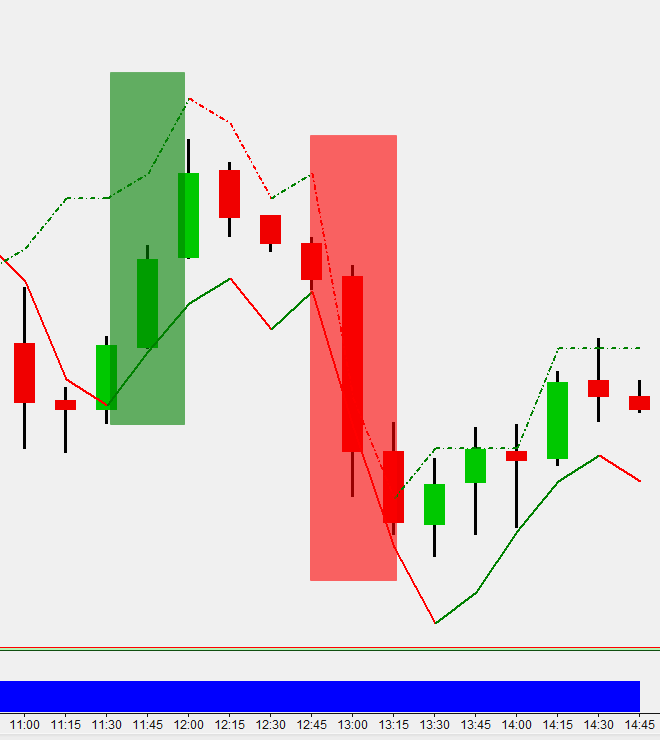

1.It has to be on region 1.
2.The settings og the colors are on the Settings and Inputs tab.
3. Ill share the code later today when Im back home.
[2017-11-27 14:38:52]
nicktrader - Posts: 814
@Yon
I got it and understand the coloring. It changes the color for the complete background. I thought the coloring is sepate for each event.
In Region 2 it works too.
Many thanks

Zosimus - Posts: 345
Yes it is much more complicated to change the colors for each event separately.
If you use region 1 it will fill the space between the 2 lines.
