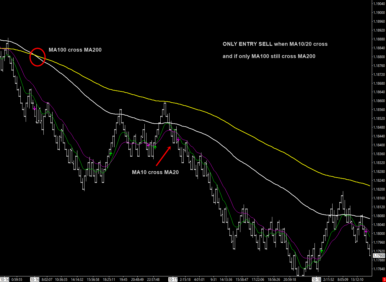

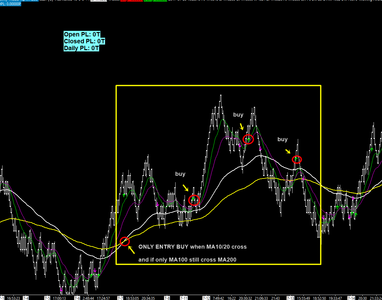

I am using the Moving Average Crossover
1) Moving Average Crossover (MA10,MA20)
2) Moving Average Crossover (MA100,MA200)
Entry
Entry buy if MA10 cross MA20
AND only IF MA100 and MA200 at cross buy

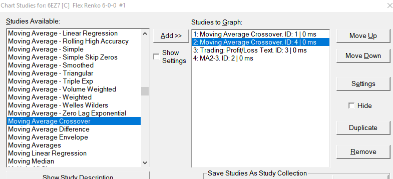

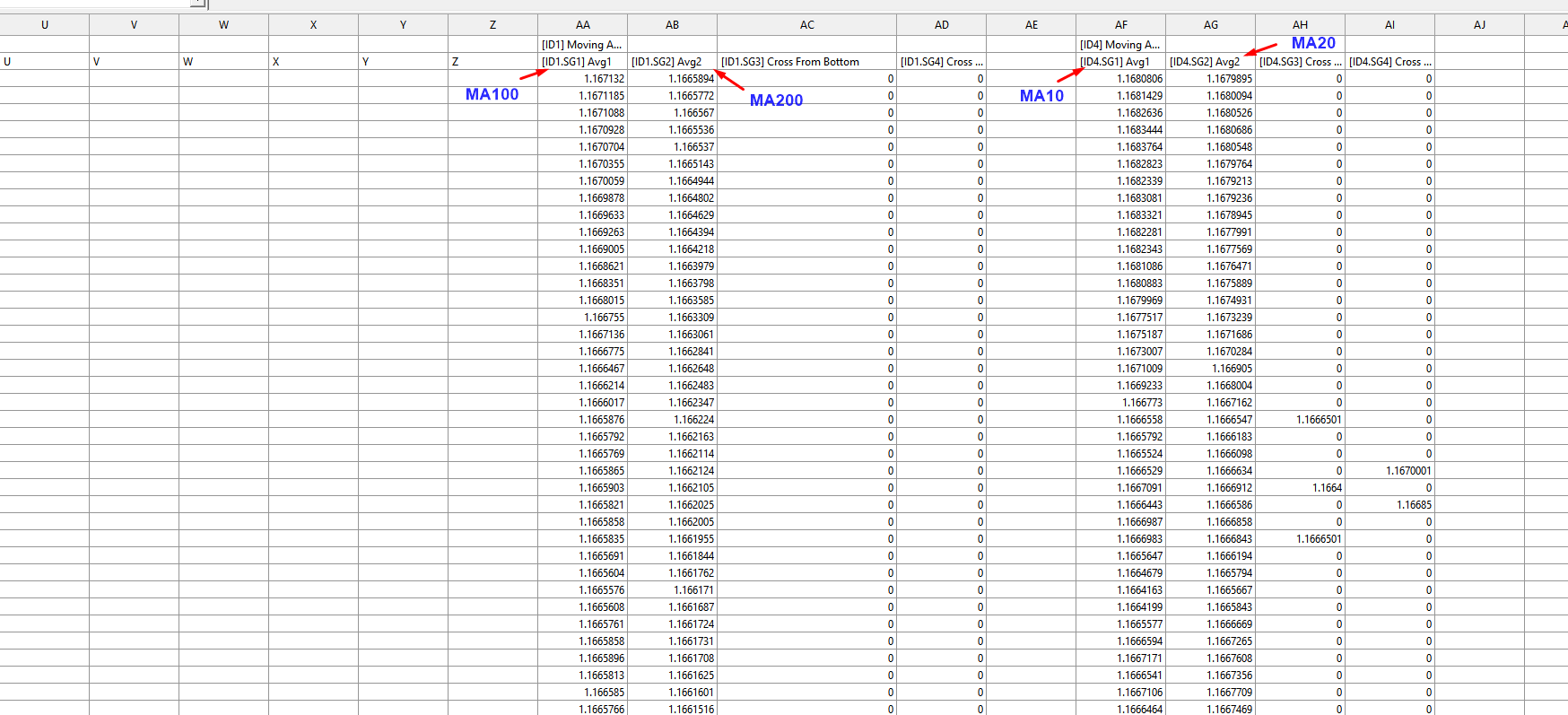

how to code to put and entry buy and sell using the spreadsheet
Please refer the attachment
i have coding the code..but still doest work and dont know where to start.

[2017-11-23 16:57:05]
Sawtooth - Posts: 4355
Try this:
K3:
=AND(ID1.SG1@3>ID1.SG2@3,CROSSFROMBELOW(ID4.SG1@3:ID4.SG1@4,ID4.SG2@3:ID4.SG2@4))
M3:
=AND(ID1.SG1@3<ID1.SG2@3,CROSSFROMABOVE(ID4.SG1@3:ID4.SG1@4,ID4.SG2@3:ID4.SG2@4))

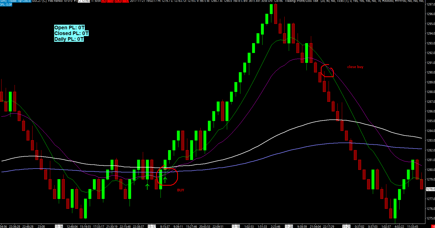

Donz - Posts: 17
Please help for L3 and M3
IF entry buy , will close with sell if MA cross

[2017-11-23 18:55:38]
Donz - Posts: 17
just found it...and test it
buy exit
=CROSSFROMABOVE(ID4.SG1@3:ID4.SG1@4,ID4.SG2@3:ID4.SG2@4)
sell exit
=CROSSFROMBELOW(ID4.SG1@3:ID4.SG1@4,ID4.SG2@3:ID4.SG2@4)
thank u for help
