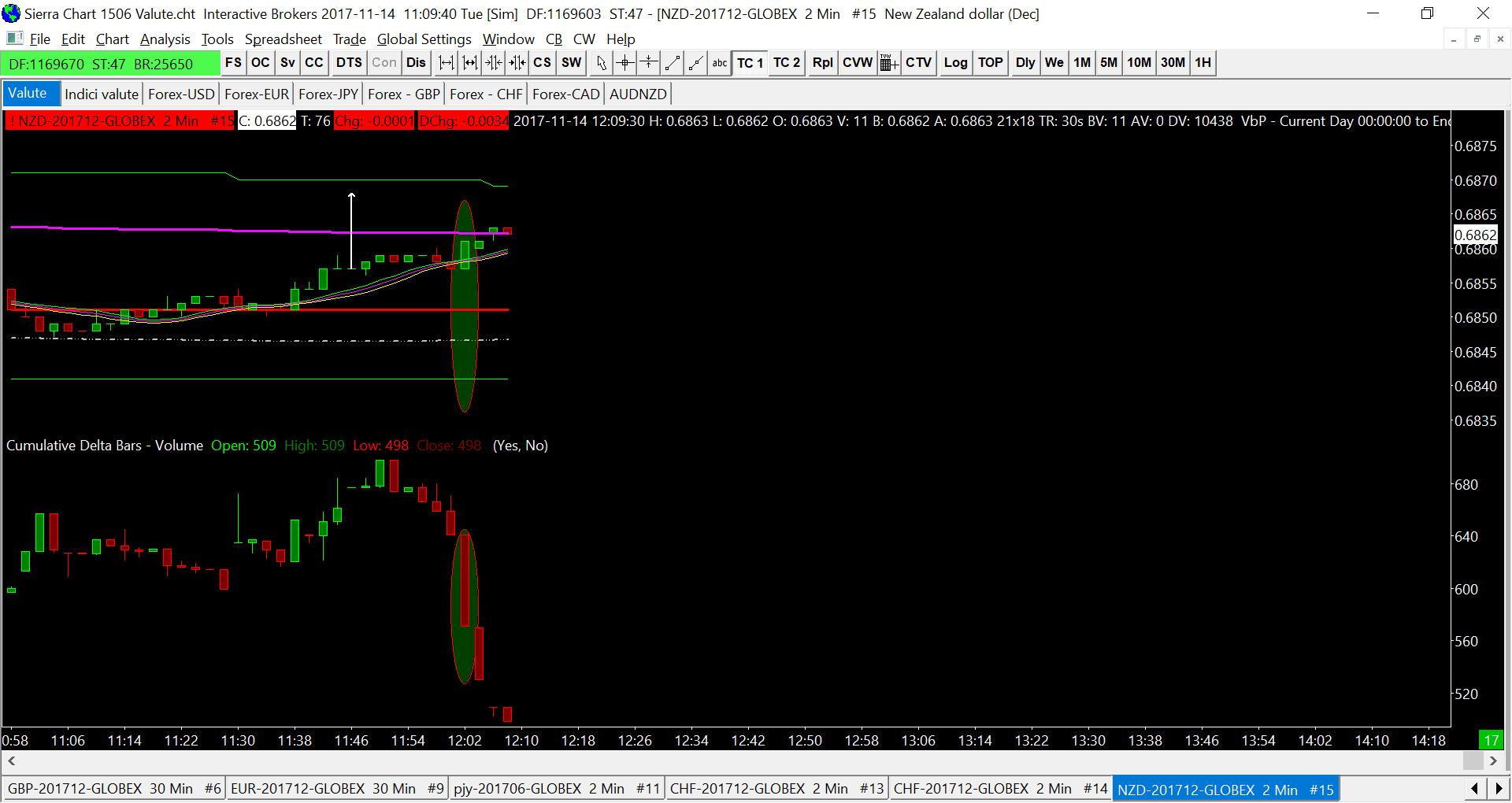

in the attached file you can see the NZD symbol. Please note the sorround bar and its cumulative delta volume study.
Do you know why the symbol bar is green but the study bar is red?
cumulative delta volume should be >0 because price is rising... isn't it???

The Cumulative Delta - Volume study colors the bars based on whether they are Up bars (green) or Down bars (red),
The documentation will be updated shortly to explain how the bars are colored. You can find the documentation for this study here:
Cumulative Delta Bars - Volume

The information given in post #3 was not completely correct.
It has been corrected.
Refer to the documentation for this study here:
For accuracy you must use the Sierra Chart Exchange Data Feed:
And not the substandard Interactive Brokers Data Feed. Otherwise, the data you are looking at is just simply not accurate or much less than accurate.
