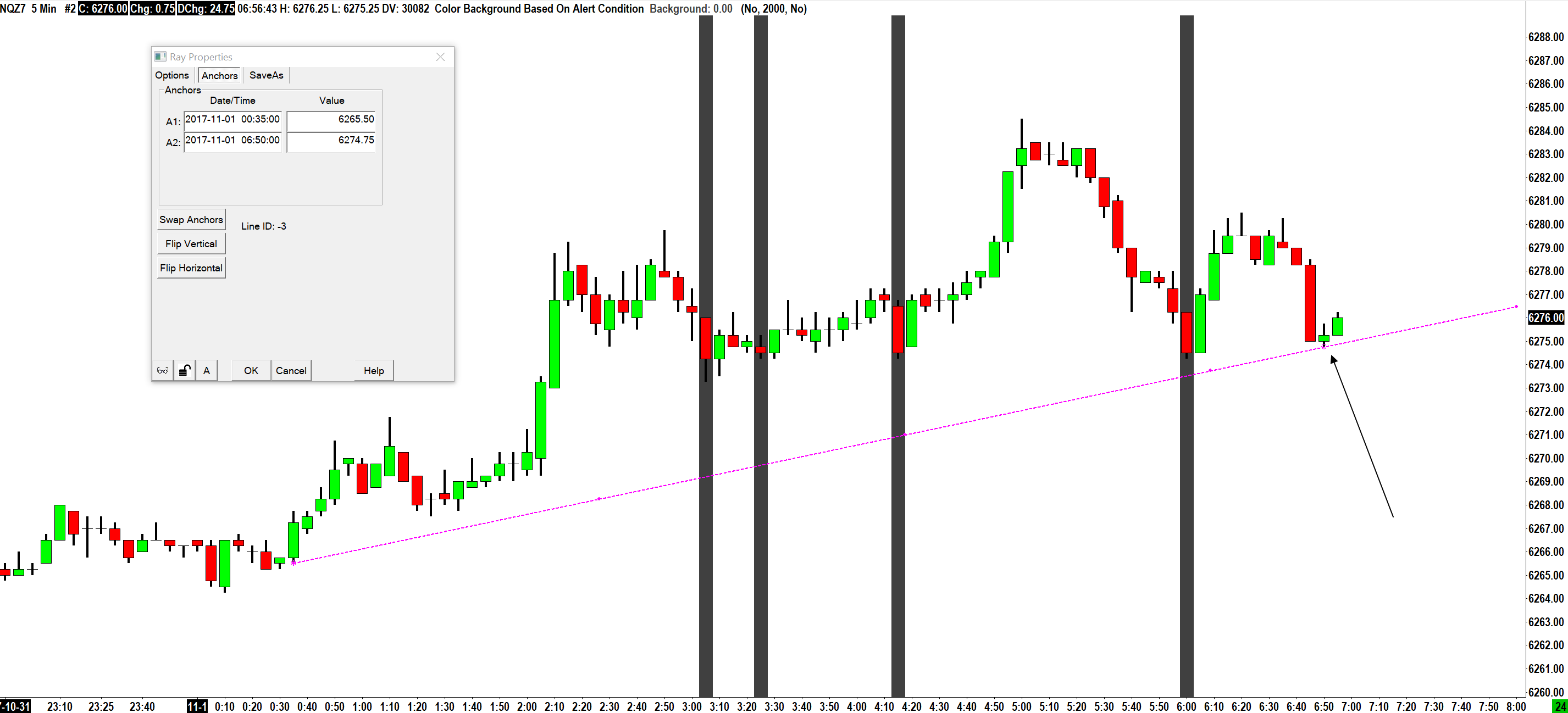

Question about this documentation: Study/Chart Alerts And Scanning: Referencing Chart Drawings
In the attached image, I'm using Color Bar Based On, with this formula: CROSSFROMABOVE(C,UDID[3].A2)
UDID[3].A2 is the drawing/anchor I have selected.
I can see that this anchor has a value of: 6274.75
I can also see the study is using that price to push "True" conditions based on historical instances of the price crossing the price level 6274.75 from above.
Is there a way to only show this data going forward or should I just set # of bars to calculate to 1?

[2017-11-01 17:33:24]
Yes. This is what you need to do.
