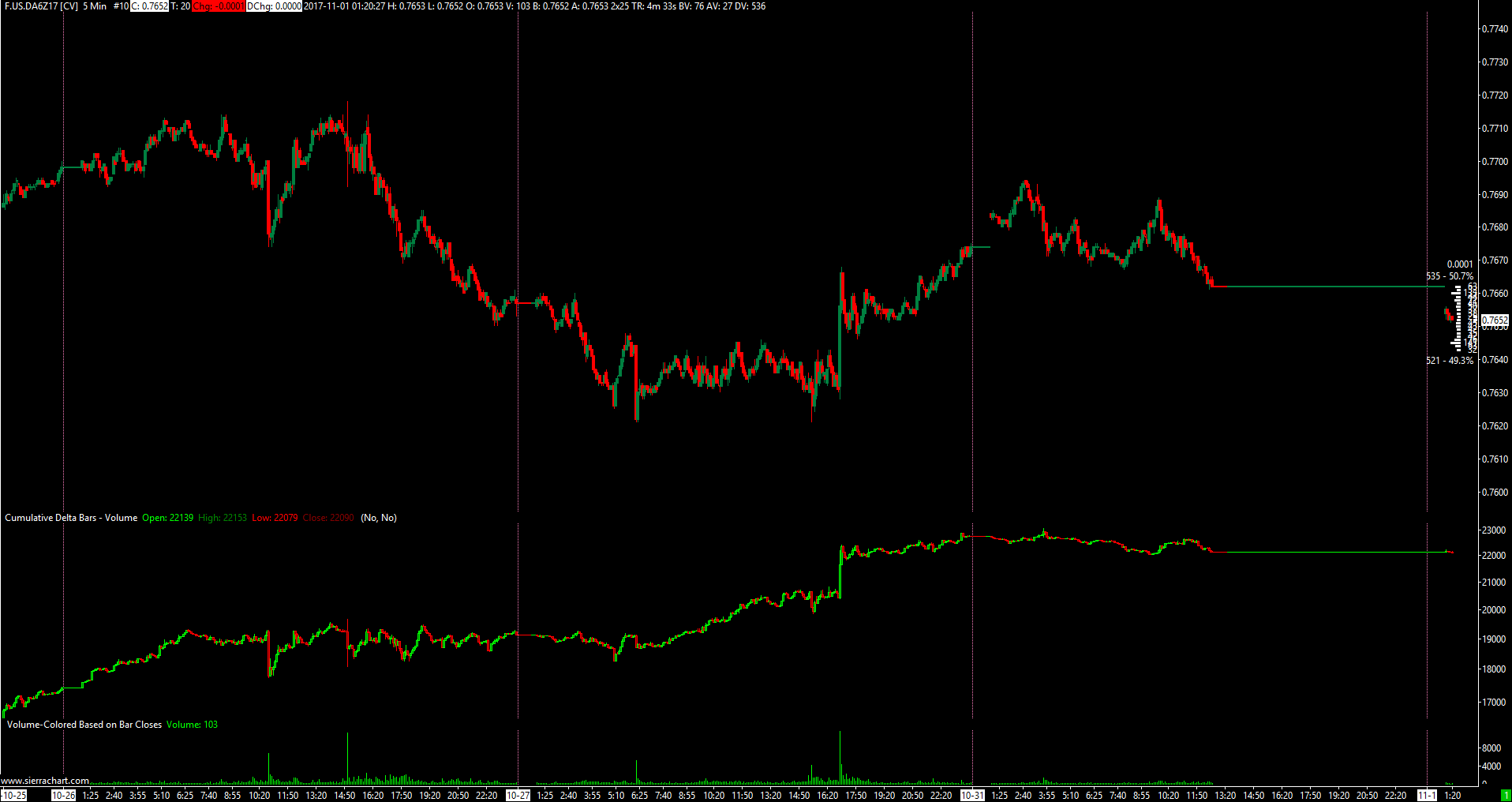

I am getting the feed, I am connected, I have deleted/downloaded AND recalculated but there is still massive gaps in yesterday from 12:30 to the open NOW. This ALSO happened Tuesday/Yesterday with ALL of Monday missing. DOES ANYONE KNOW WHY THIS IS HAPPENING????? It must have something to do with when I turn the computer off as that's when the gaps start. I don't understand.
Specifically F.US.DS67Z17 - Aud Dec Contract
Any help greatly appreciated. Thank you

http://www.sierrachart.com/image.php?Image=1509488486351.png
attachmentchart.bmp - Attached On 2017-10-31 22:13:11 UTC - Size: 7.43 MB - 682 views

This just must be affecting you. It appears as though there is a problem downloading historical Intraday data.
Follow the instructions here:
[2017-11-01 05:49:42]
NCooley - Posts: 20
Excellent THANK YOU!!
Updating server seems to have done the trick.
