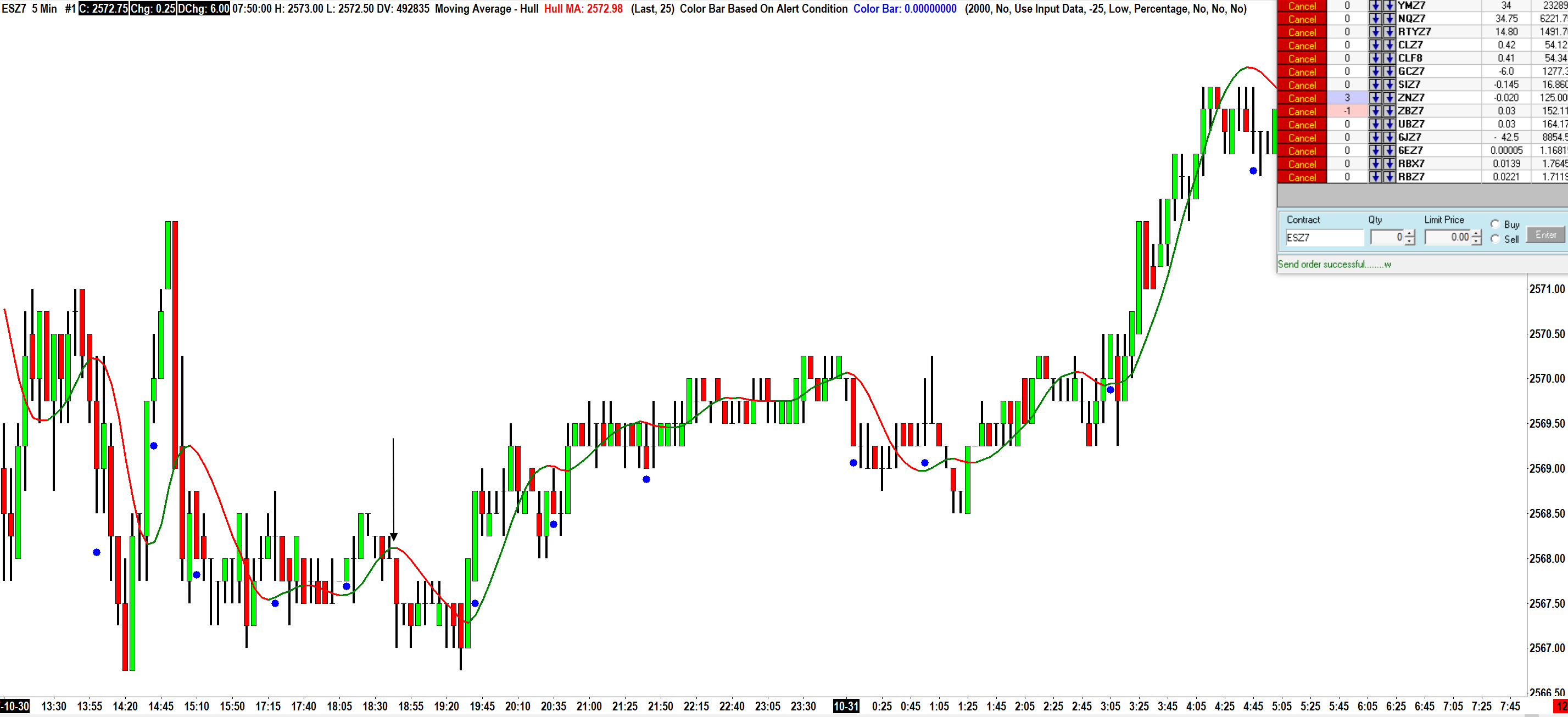

I am using this formula: =OR(AND(ID1.SG1[0] > ID1.SG1[-1],ID1.SG1[-1] < ID1.SG1[-2]),AND(ID1.SG1[0] < ID1.SG1[-1],ID1.SG1[-1] > ID1.SG1[-2]))
Which is derived from this page (I added ID1. in front of all instances of SG1, that was the only change): Study/Chart Alerts And Scanning: Alert Formula Examples
I also added the Auto-Coloring Based on Slope.
In the image linked, you can see places where the slope changes and therefore the line changes color, but I don't get the blue point which is my output for the Color Bar Based On Alert Condition Study: http://www.sierrachart.com/image.php?Image=1509449840181.png
I am looking for a way to get a visual notification in the form of an arrow or point whenever the slope changes (not just the line coloring). Any ideas?

[2017-10-31 18:24:10]
infpz - Posts: 826
OK I changed the value format to .00000001 and still there are obvious changes in slope that are not being marked. Attached is an example with a black arrow.

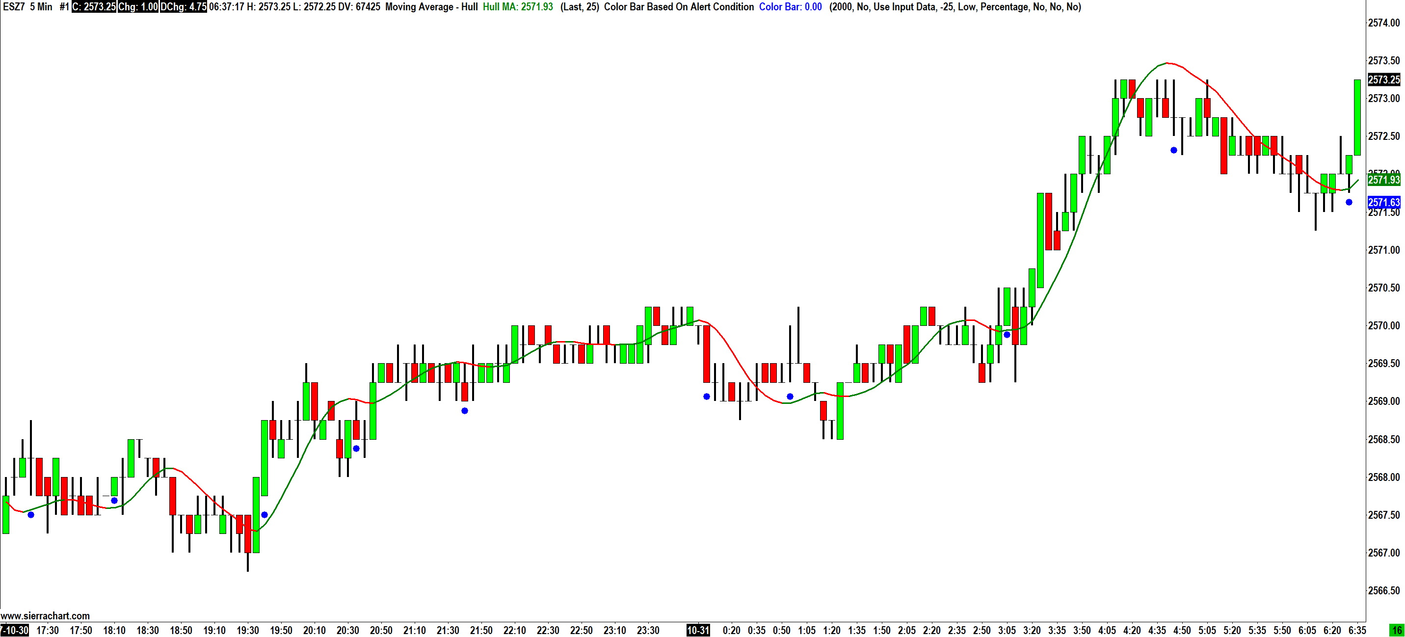

[2017-10-31 19:24:03]
mkata - Posts: 104
infpz,
On your alerts tab click on the check box named:
Use Full Precision When Evaluating Alert Formula
[2017-10-31 19:34:53]
infpz - Posts: 826
This looks like it is working - thank you!

[2017-11-01 10:53:53]
infpz - Posts: 826
I did this on the color bar studies - I see by removing that, and doing it on the moving average - it seems to be working without the precision option selected. Thanks all. PZ
[2017-11-01 17:50:17]
Yes. That is what you need to do.
