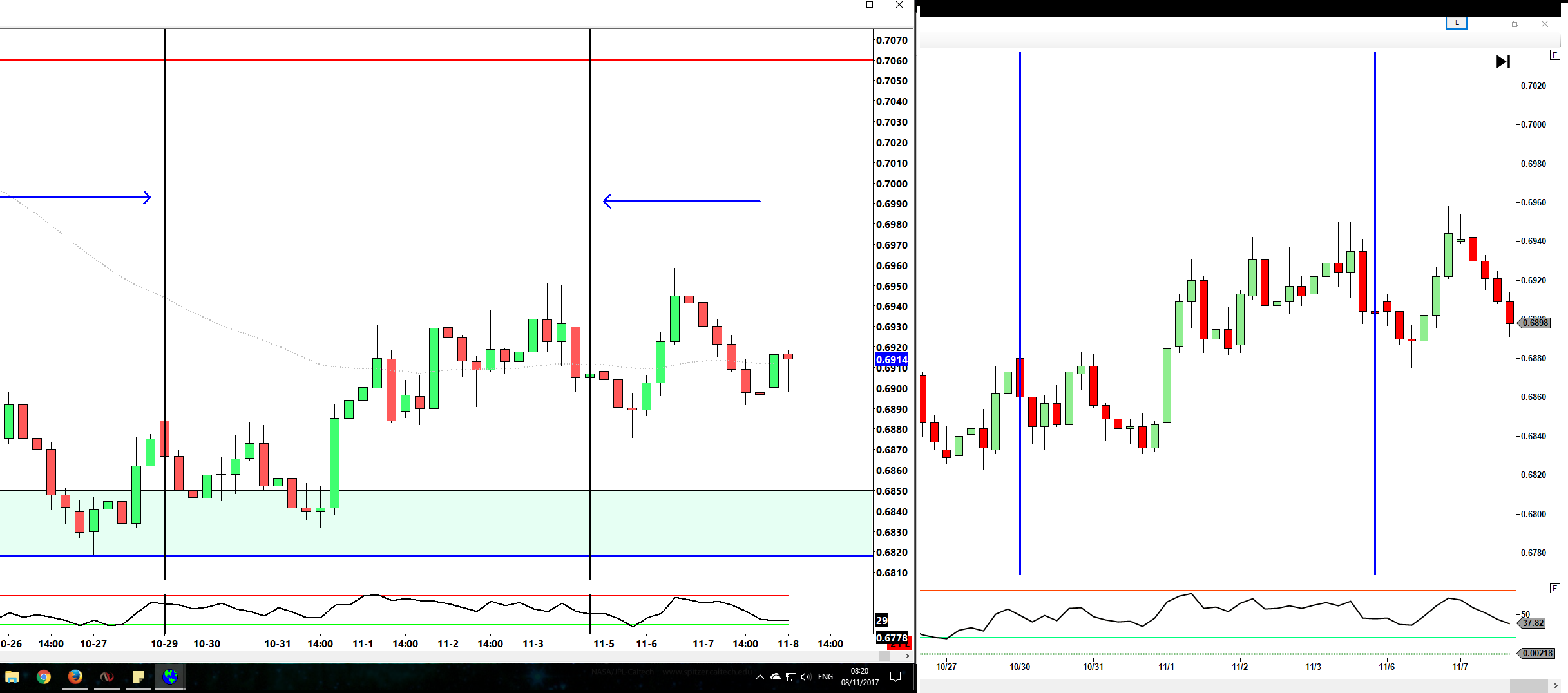

Yes, I tried that also and set to New York but the bars on the chart(s) are always different in comparison to my other platform during that week.
I'll post both pics in order to let you see what I mean by that...
The chart is the NZD/USD 4 Hr candles, pay attention between the verticals lines of each chart (same lapse of time of the daylight saving time week)
Unfortunately, I can't show you the hour printed on the timescale of both platform at the same time but, during that week, is different (reason why the chart are different)
Thanks for the help.
F.
imageDifferencies.png / V - Attached On 2017-11-08 08:29:15 UTC - Size: 175.65 KB - 628 views

User630996 - Posts: 25
Is the chart on the left LMAX, and the one on the right Ninja/FXCM?
[2017-11-08 13:56:58]

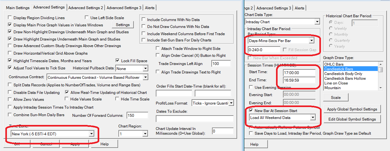

And is this what your settings look like:
Date Time Of Last Edit: 2017-11-08 14:03:08
imageSettings.png / V - Attached On 2017-11-08 14:03:00 UTC - Size: 78.03 KB - 640 views
[2017-11-08 14:32:13]
Fabio - Posts: 154
Yes exactly, left Lmax through S.C. and right Fxcm through N.T., sorry I forgot to tell this before.
About the settings instead, I've forgotten to modify the session start and end time as per N.Y.
I never checked it to be honest because I thought that modifying the time zone from London to New York it would have been settled automatically, of course, my bad.
Now I modified the session times as per your picture and both platforms are exactly the same....
You've been really helpful, with your pic I found out straightaway where was the problem :)
