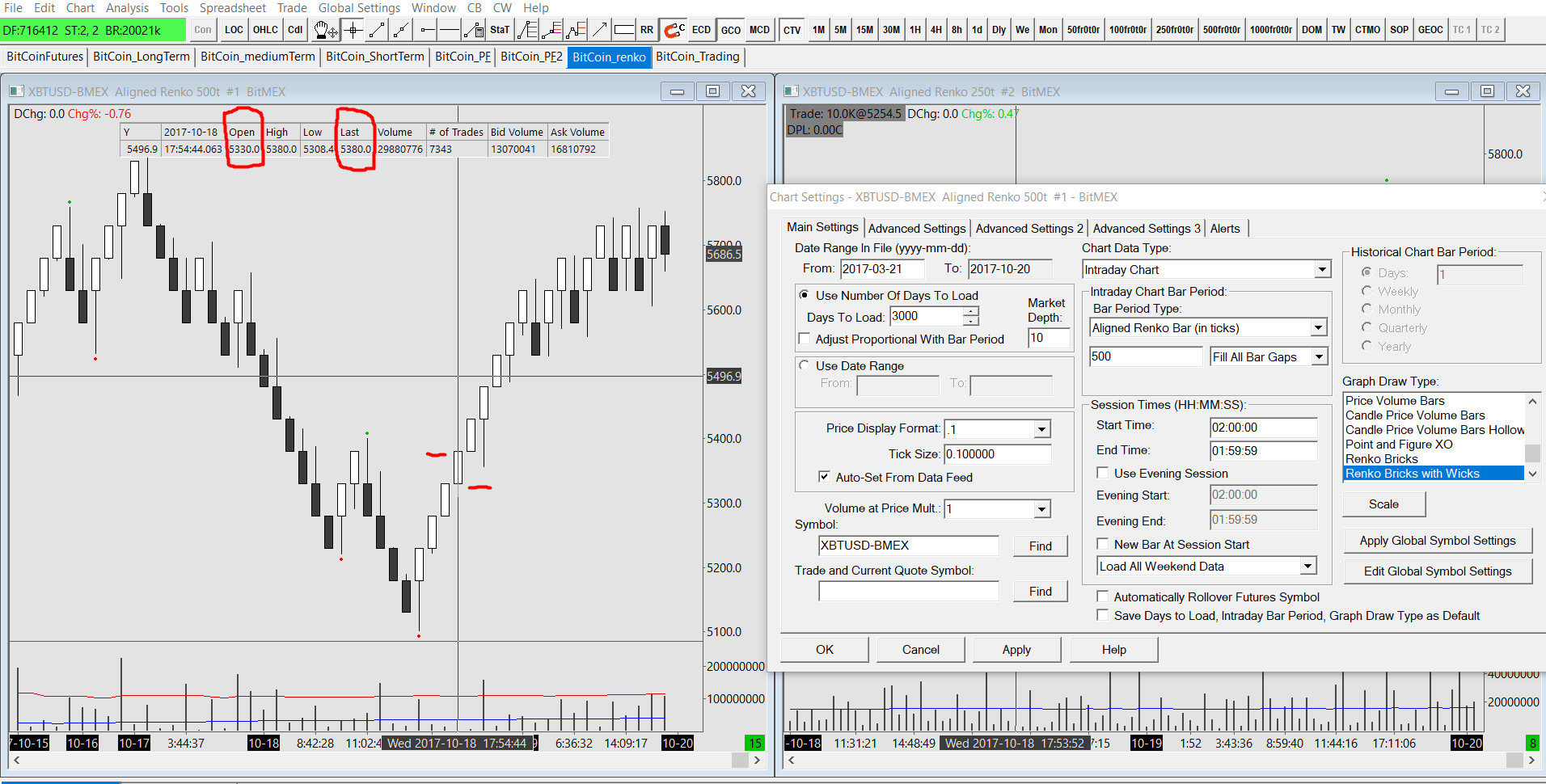

one more issue ,
How do i make the Renko bars line up , so that the open and closes are at round numbers
in this case like , 5300 5350 5400 5450 5500 .....

[2017-10-20 01:36:19]
Use Aligned Renko bars:
Renko Bar Charts: Opening Price for First Renko Bar and Alignment (Aligned Renko Bars)

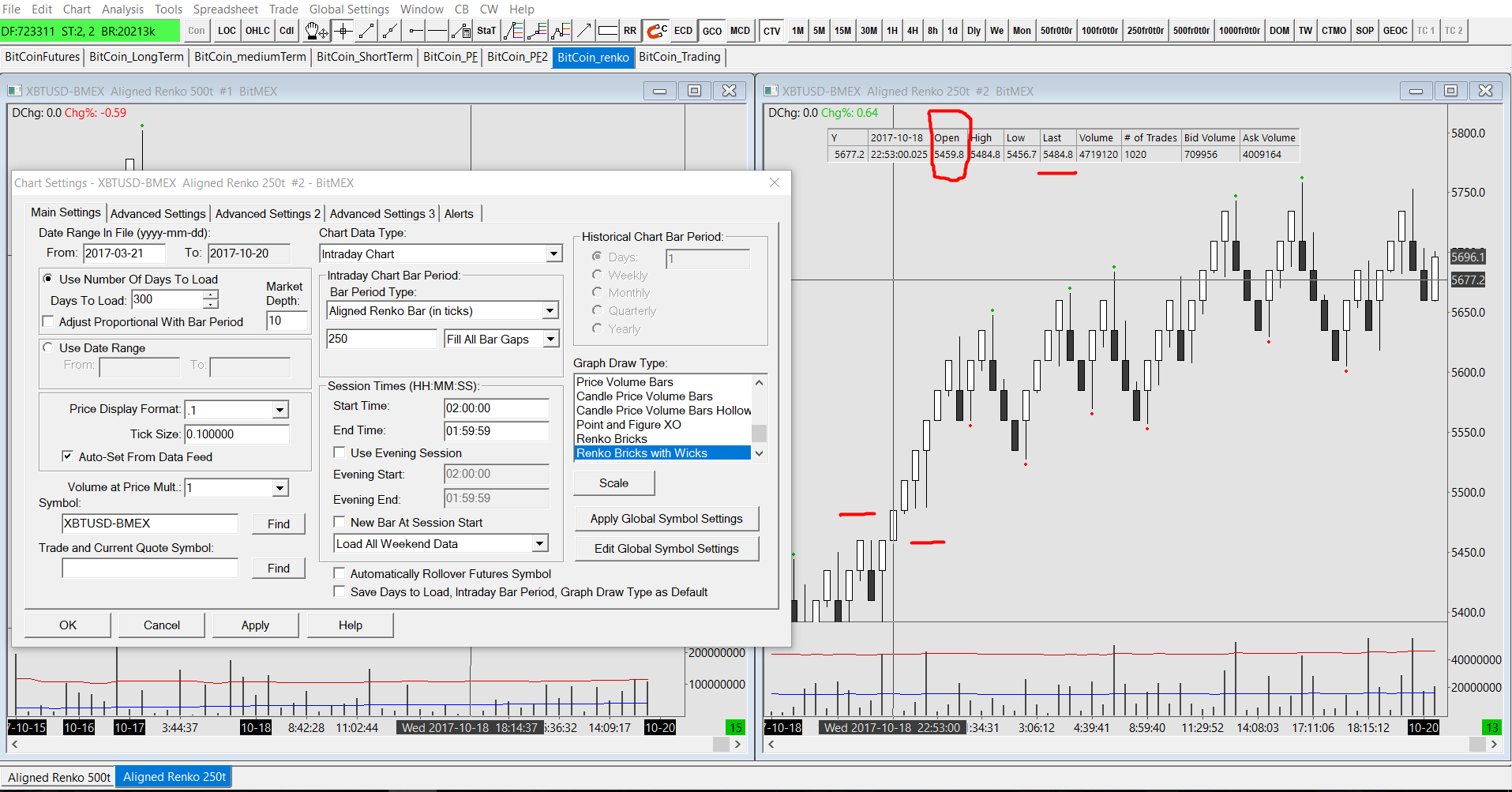

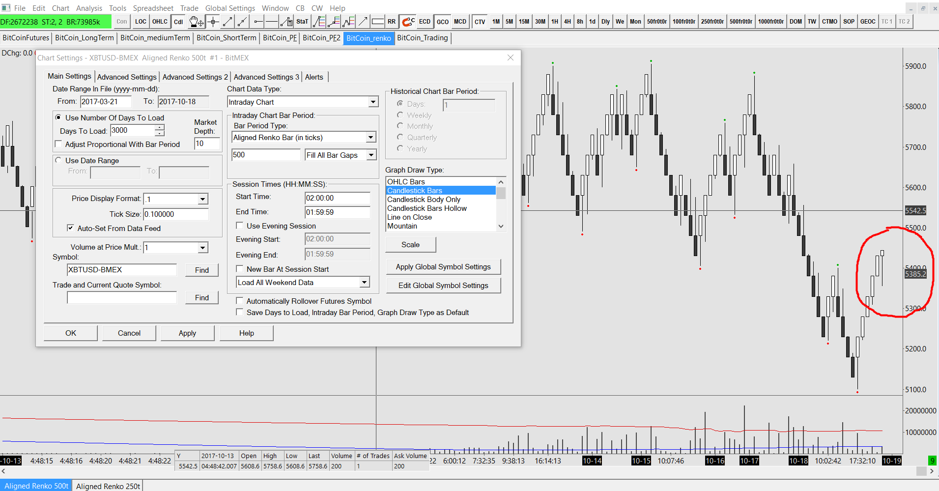

screenschot #1 , i am not able to align the candles ,so that the open and close are on round numbers 5350 5400 5450 5500 .....

[2017-10-20 04:49:29]
This is not always going to be as you expect. Enable New Bar at Session Start in Chart >> Chart Settings to reset the alignment each day. Otherwise, it can get out of alignment based upon the defined logic for building the Renko bars and the underlying price data.
