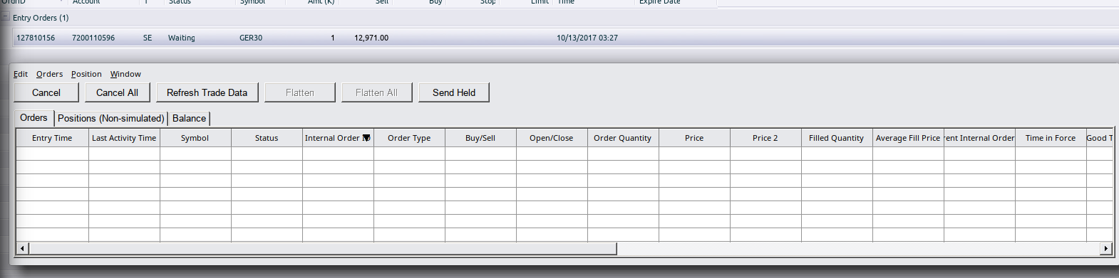

Latelly i am experiencing alot of problems with FXCM orders. Orders disappear on SierraChart but stay on FXCM server.
Last order it happened, it had FXCM orderID "127810156". The time I am writting this, it still exists. In the image attached, the background window is the "Orders tab on FXCM's Web tradestation", while at front is SierraCharts "Trade Orders and Positions".
How to prevent/fix this? How can I make the missing order appear ? Another time, the order reappeared after some time ( a few hours if I am not mistaken, happened last friday).
Thanks.
imageScreenshot_20171013_090840.png / V - Attached On 2017-10-13 08:09:04 UTC - Size: 37.92 KB - 428 views

[2017-10-13 08:35:56]
You should now see the order. Confirm.
This was the last activity on it:
Order  2017-10-13 07:28:51.342  GER30  FXCM order update (Order Status). Text: 19915;DAS 19915: ZDas Exception ORA-01403: no data foundORA-06512: at "E10R2.API", line 8204ORA-06512: at line 1  7696
We need to ask FXCM about this and we are going to see if we interpreted the order status correctly. Almost certainly we did. Unfortunately FXCM is not the best designed system and can have issues.
Date Time Of Last Edit: 2017-10-13 08:37:48

[2017-10-13 09:06:43]
No not at all. We are still looking at the problem.
It appears to be a case, where the client order ID is not updated on an order rejection. And we have to revert to the prior one, but the thing is, we understand this may or may not be the case depending upon the FIX implementation and if we have had it wrong, then this would have been an ongoing issue. So we wonder if FXCM recently made a change.
This is something that we simply would never have made a mistake with, because we we clearly read the documentation and we do extensive testing in this regard. So something must have changed on the FXCM side or there is inconsistent behavior. One or the other.
Date Time Of Last Edit: 2017-10-13 09:07:46
[2017-10-13 09:12:59]
We are releasing the solution to the FXCM demo environment now and we are testing.
We were able to replicate the problem on the demo system. There is little doubt in our mind FXCM has changed something. This kind of problem simply would never have existed in the past. It could not have due to extensive testing we do.

Update has been released.
Let us know if you see any further issue. One way to test this is enter a buy limit order, and then manually adjust it significantly above the current price. This modification will be rejected. It should then return right back to where it was previously. You can then cancel it. This confirms the issue is resolved.
