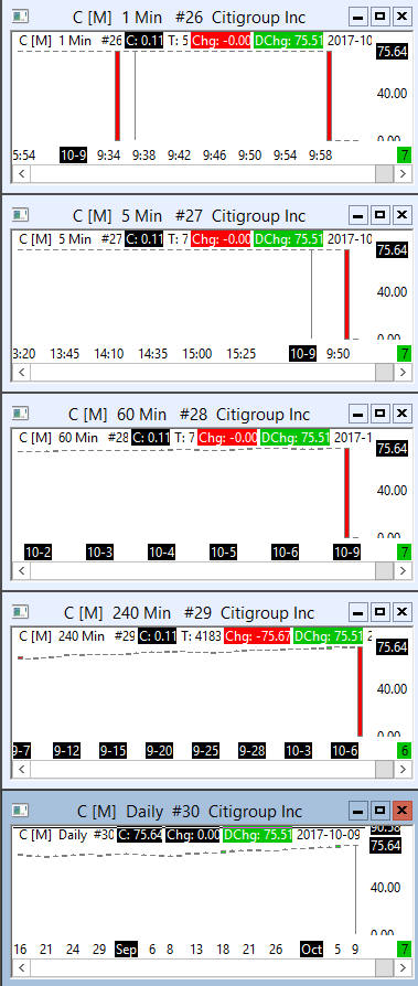

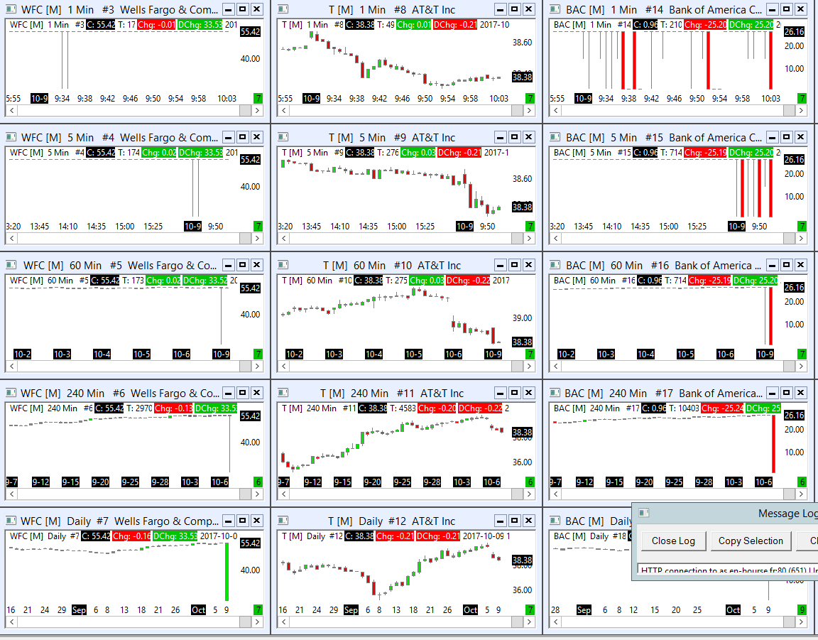

Today I realize there is a problem with some US charts from the sierra chart feed.
This include : Citigroup, Bank of America, Wells&Fargo, ...
The bug is going on at the moment, in M1, M5, H1, H4, D1.
Here are 2 screenshots.
Thanks for your help,
Regards,
imagecitigroup.PNG / V - Attached On 2017-10-09 14:09:36 UTC - Size: 31.87 KB - 465 views
imagebank_americ_and_wells_fargo.PNG / V - Attached On 2017-10-09 14:09:39 UTC - Size: 89.11 KB - 436 views

We have contacted our data provider Barchart about this. This is an issue on their side. This is a serious issue. Once they correct the problem we will clean up the historical data.

We got this from our data provider Barchart about this:
The NYSE switched their feed protocol over the weekend, and it appears things with ".A" or ".B" are being sent through by us without the ".A" or ".B". We will have a fix out shortly.
