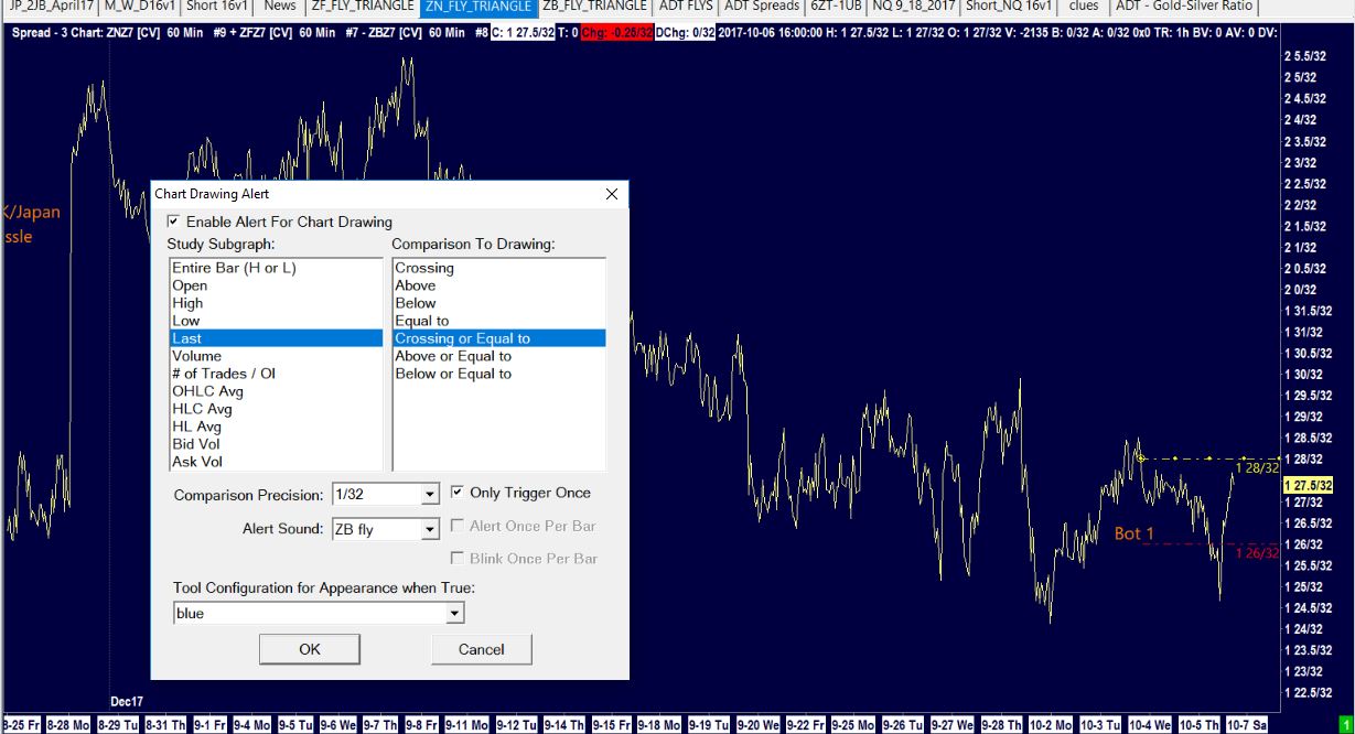

Chart Drawing Alert: Spread - 3 Chart: ZNZ7 [CV] 60 Min #9 + - , Horizontal Ray #14, Last (125 1/32) Crossing from below (1 28/32) | Alert: ZB fly
Received this alert 10/8 2017 10:23amEST.. Error alerts received almost every day.
Attached is image of chart and Image with alert for chart Drawing settings..Please advise how to correct..Thankyou
http://www.sierrachart.com/image.php?Image=1507478426355.png
imageerror alert.JPG / V - Attached On 2017-10-08 16:04:12 UTC - Size: 125.51 KB - 496 views
[2017-10-09 16:59:56]
This really is difficult for us to resolve. The most likely reason for it has to do with the fact that this is a spread chart and depends upon data from other charts. And until those other charts are loaded, the values of the Spread study are going to be different which can trigger the Chart Drawing alert.

ALL the charts that the spread study is dependent on, are simultaneously running in the back ground within the same chartbook and same time frames.
So I am not sure if I understand your response. Is there any work around? Would a spread sheet do any better? It would be nice to eliminate the false positives. I have had several erroneous alerts today. Thank you
