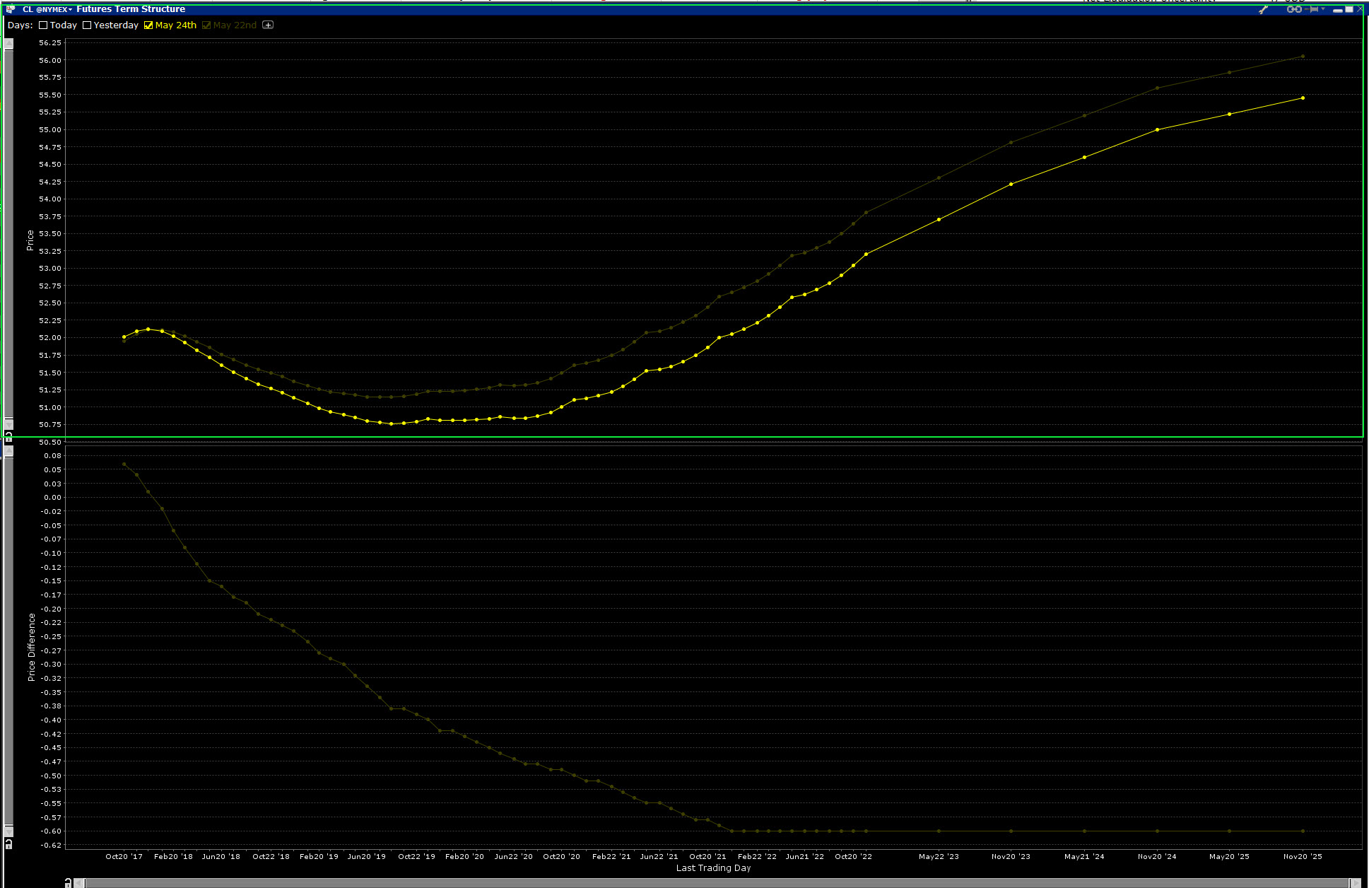

The single chart I use most in my work is what I call a "Term Structure" chart. See attached file for a sample from Interactive Brokers of what I am talking about. This is the same thing that Bloomberg calls 'CCRV" (Commodity Contract Curve). I primarily use only the top half of the IB chart (green rectangle in the attached grab), and wish I could turn the bottom off. Very important to be able to chart the term structure for different dates. IB does this with different shades of yellow dots. Would be much better if I could choose colors for each date. Also very important the the chart update live in real time as the various prices on the curve change throughout the day.

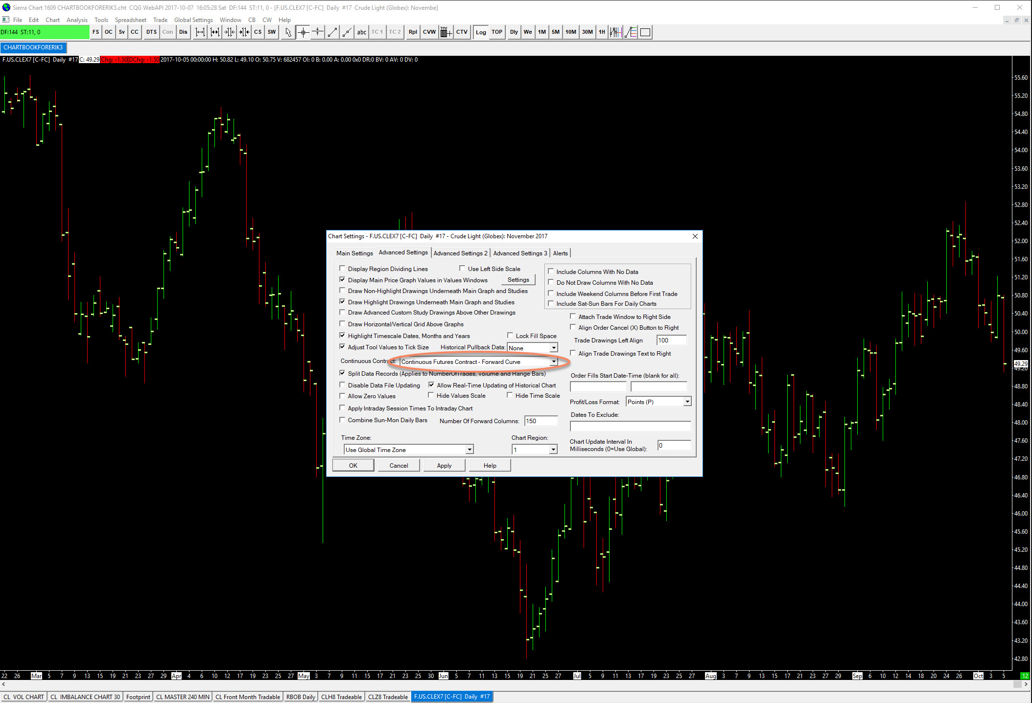

At first I assumed you had the same thing and were just calling this a "Forward Strip" chart, as a lot of people use the phrase 'forward strip' to refer to a futures term structure. But after following the instructions in the help for creating a 'forward strip' chart, what I get just looks like a regular bar chart. I grabbed what I am seeing with the chart settings dialog open to show you exactly what I am seeing and how I set it up. I followed the steps exactly as given in the help section for forward strip.

In the case of outright futures contracts, do not manually type a symbol.
You must always use the symbols found in File >> Find Symbol.
The problem is you are using the wrong symbol, it only contains a single digit year, and that is going to create more problems than just this, in the case of when using CQG. Here are the instructions to change the symbol of the chart:
Changing the Symbol of a Chart

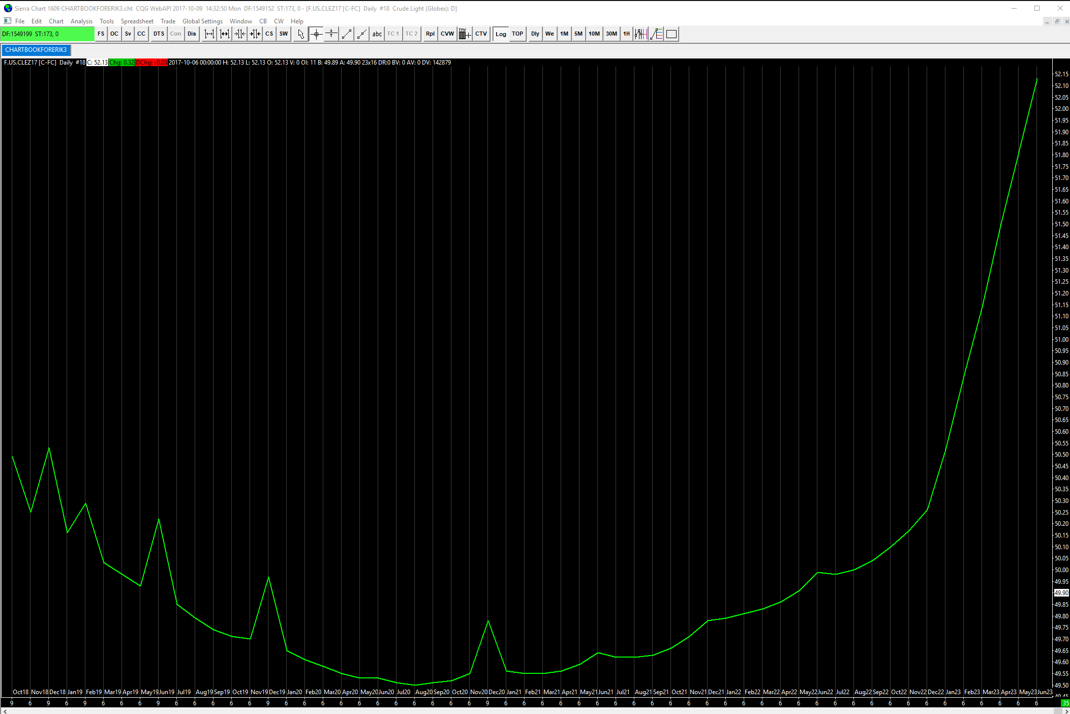

Navigating to the symbol from the tree (rather than typing it) did indeed change the behavior, but frankly not in a terribly useful way. Please see attached what I am seeing now. Here are my concerns:
1. In default OHLC Bar view, the bars don't make sense on this type of chart. Per your instructions, I did change to line-on-close (hence this result), but frankly I don't want or have use for a line-on-close chart. I need a series of dots showing my the last or settle price for each contract.
2. It is essential to be able to display multiple curves as of different dates. This appears to only allow display of the CURRENT forward strip, with no ability to compare it to the strip that existed on a prior date. Respectfully, this chart is not useful with this limitation.
Is there a way to display multiple curves (for different closing dates), and if so how do I do it? If not, do you want help designing something useful? I don't mean to be sarcastic - I'm totally serious. I'm a former software engineer and would be happy to do a detailed design for something much better if you have sincere interest in doing it. But if this is a feature that your other users are not asking for and therefore not a priority, I understand and respect your choice, but I don't want to waste my time and energy designing something better unless you have a sincere interest in implementing it. With all due respect, this function is not useful in its current form, unless I am missing something and there is a way to choose something other than line-on-close and to display multiple settlement dates simultaneously, as in the sample I sent you from IB in the OP. In case it is not clear, the way an analyst uses this chart is to visualize how the term structure is evolving over time. Without curves showing the term structure on prior dates, the function really isn't useful.

1. When using Line on Close, you are seeing the last trade price or settlement for each contract. That is definite.
2. This capability will come later.
Yes, but when we are ready we will let you know at that time.
We have had many requests for this, just something we have not yet gotten to.
