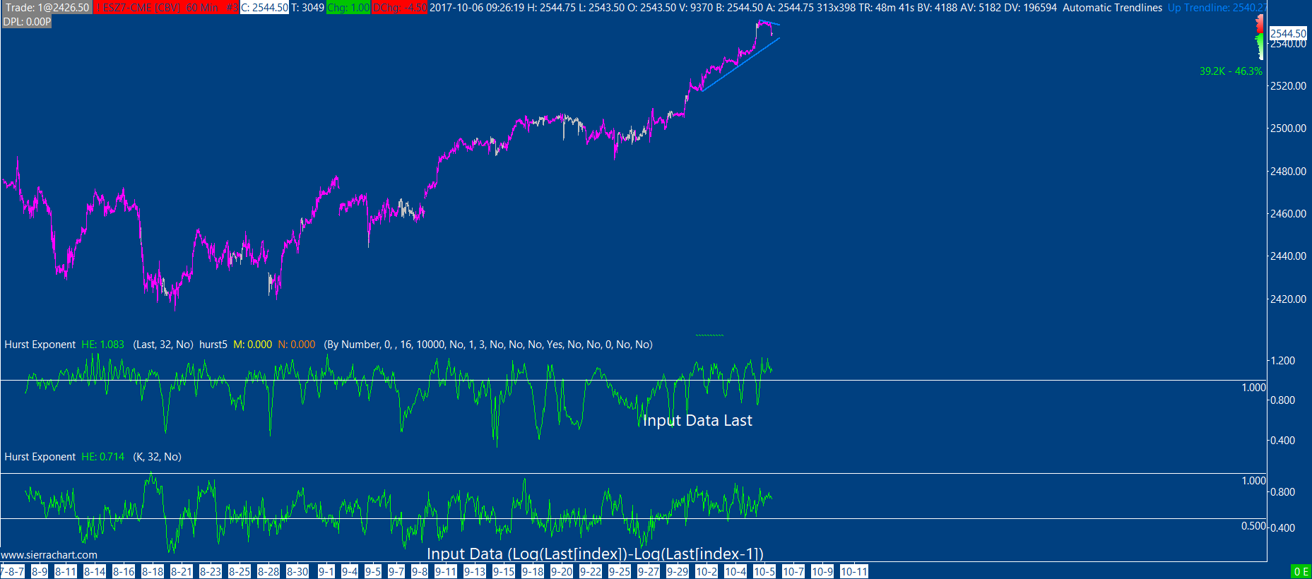

While reviewing the code I saw that the input data is not transformed to "return" data. I tried to modify and make my own study but some of the functions are not available. Could you please make the data either return from previous close or log(input_Data[index]-log(input_data[index-1]). This would be very helpful. thanks

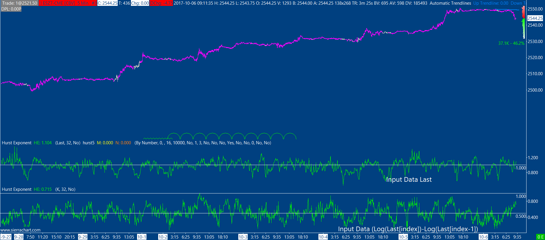

Your input data series allow you to select OHLC data which is fine . However the Hurst function is based on mean adjusted return data where the In_X is an array of normalized returns. By doing this the function becomes bounded by 0<H<1.
This is a a picture shows the difference with current calculation verse using return data and address why the current function is has values over 1 and is not centered around .5.
http://www.sierrachart.com/image.php?Image=1507295497478.png
higher timeframe and better picture.
http://www.sierrachart.com/image.php?Image=1507296382725.png

[2017-10-20 01:15:10]
This has already been implemented.
Follow the instructions here to update:
