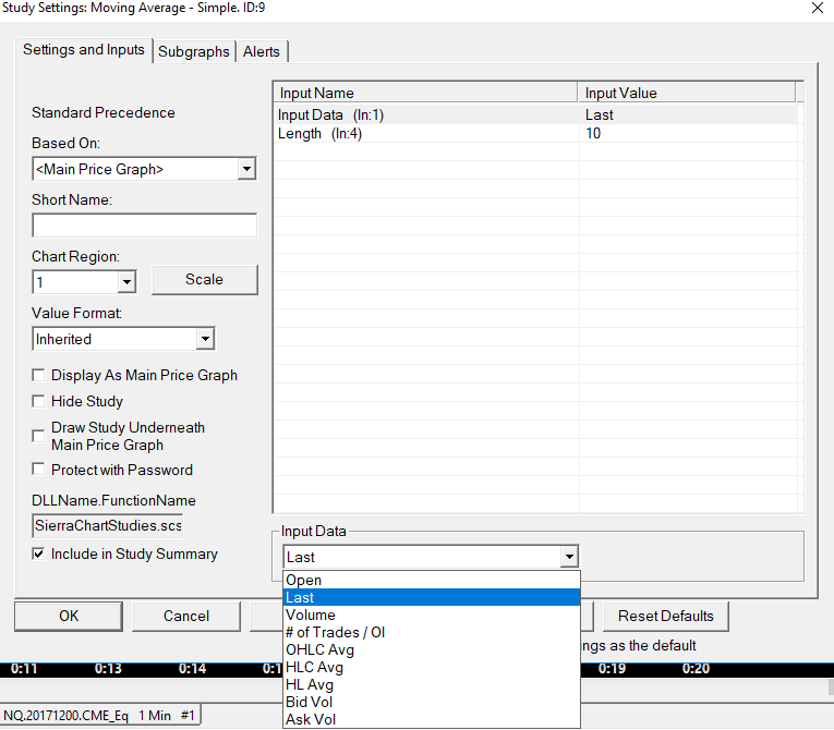

[2017-10-06 04:26:21]
User99934 - Posts: 227
Attached is what I see on my screen. There is no high or low in input. This is an older window running within a current version of Sierra. My only guess is that the updates for some reason did not update this input area. I created a new window and the input is there and now working.
image10 6 2017.PNG / V - Attached On 2017-10-06 04:18:49 UTC - Size: 30.73 KB - 433 views
[2017-10-06 04:55:15]
This is definitely very very unexpected. We are not even quite sure what would cause that.
What if you remove the Moving Average study from the chart and add it again.
Date Time Of Last Edit: 2017-10-06 04:56:01
[2017-10-06 05:00:54]
I have added and removed many studies, same thing. At least with a new window, its working now.
[2017-10-06 05:04:36]
There must have been something that was done with that chart that caused the High and Low Subgraphs to be no longer named.
It would seem unlikely though if you removed all studies from the chart and added new instances of them that you would notice this.
Date Time Of Last Edit: 2017-10-06 05:05:07
[2017-10-06 05:16:49]
You are correct. I deleted everything except number bars. I added moving average and all inputs were there.
