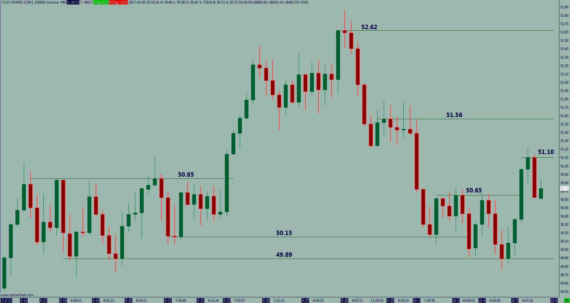

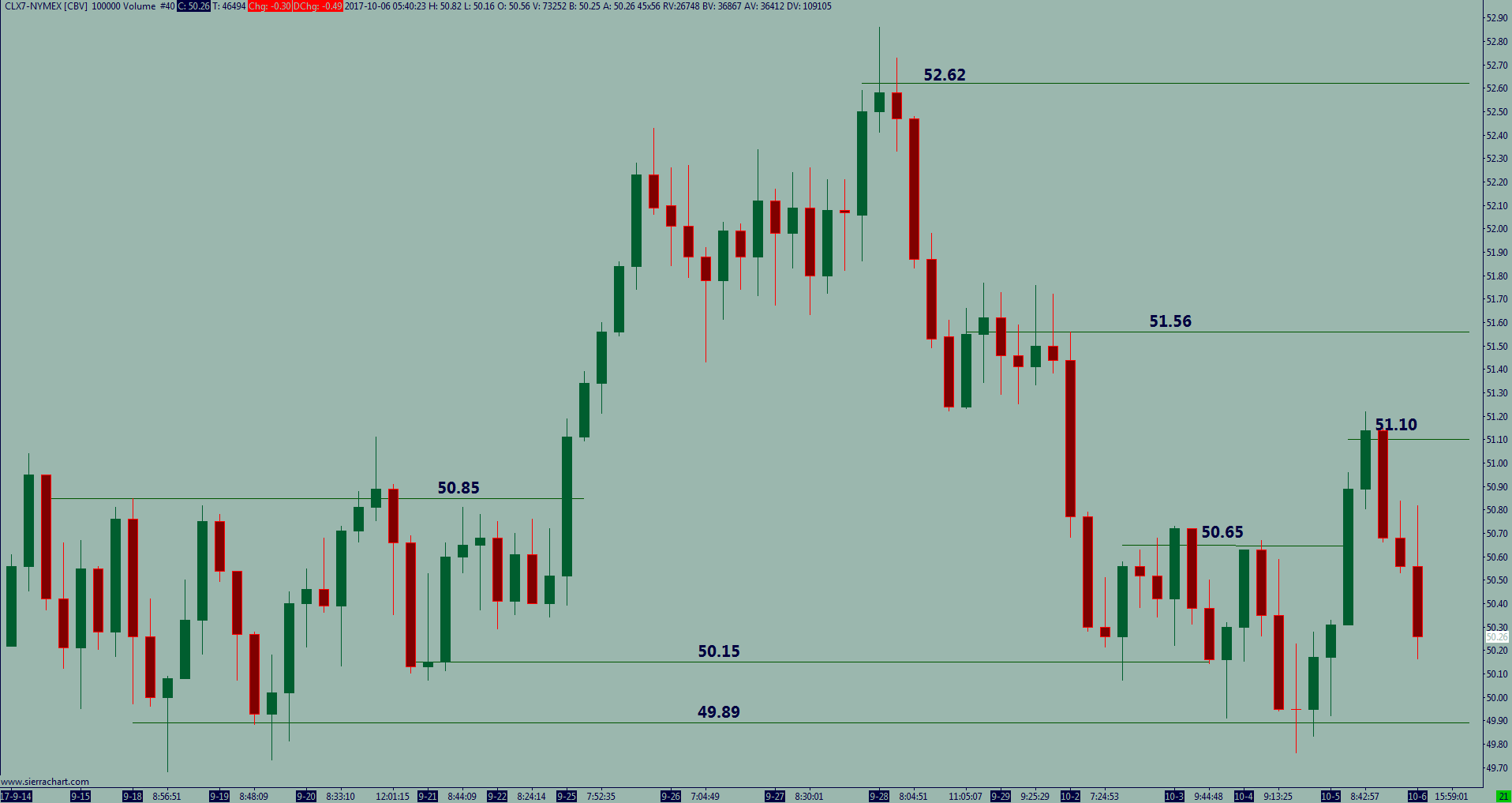

I have attached a screen shot of my chart from last night and this morning. You can clearly see the values have changes.
I do use volume candles, not time candles. However, the NEW BAR AT SESSION START is NOT enabled. The problem with having it enabled is that it may end a candle prematurely, before the volume gets to 100,000. It is quite disturbing to me that my levels and candles change every time I enter my charts because if they are not consistent then how can my levels, which I base my method off of, be consistent.

[2017-10-06 17:26:45]
In this case you need to set a Chart >> Chart Settings >> Use Date Range >> From date and not change it. But at some point you are going to have to, to minimize the amount of data in the chart.
Refer to:
https://www.sierrachart.com/index.php?page=doc/ChartSettings.html#UseDateRangeFromTo
The inconsistency makes complete sense based upon the settings you are using.
We do not see how you can completely avoid this over time if you do not want to use New Bar at Session Start.

[2017-10-09 11:51:44]
WHum7812 - Posts: 23
That makes complete sense now. If I choose to disable that setting then it will change the start date everyday unless I set the date to a finite date. It has to start somewhere.
thank you very much for your help in this matter.
