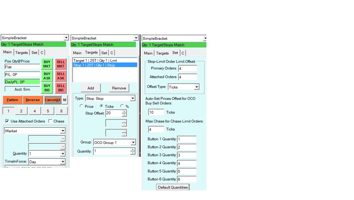

I added the parameters but something is not working well when i checked with the back test.
I attached below some screen shots of my "attach trade window" I think the problem is there.
Please Advice,
Thanks,
L.A
imageSimpleBracket.jpg / V - Attached On 2013-09-08 07:40:28 UTC - Size: 132.76 KB - 870 views

[2013-09-10 10:06:58]
Also, the image you provided in post #3 showing the Attached Order configuration looks just fine. You are doing everything correctly.

levamit12 - Posts: 5
I got it Change from tik to points work well!!
