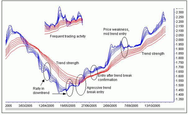

I’ve been exploring, and have been quite happy with Daryl Guppys’ Multiple Moving Average system, which mixes two set of EMA’s representing Speculative $ and Big $, and makes the trend almost impossible to ignore. (Studies>Add Custom Study>Kiwi’s stuff > Guppy MMA *or* Studies>Add Custom Study>User Contributed Studies> Guppy MMA)

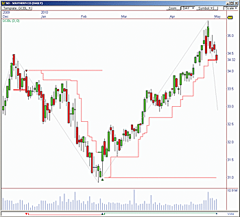

Part of his method includes what he calls the Count Back Line, for a heads up regarding trend change as well as a stop loss once onboard.
In a nutshell it trails a line, (downtrend) much like Kiwi’s Trailing Stop, that keys off a new low, and measures back 3 higher-highs of preceding candles, with the current candles high as the starting point.

The first image is what I’m after, the second is a sample of the GMMA

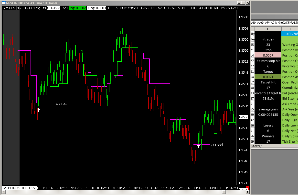

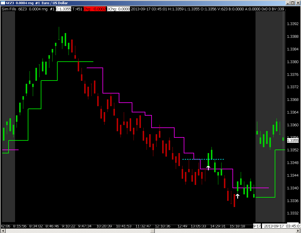

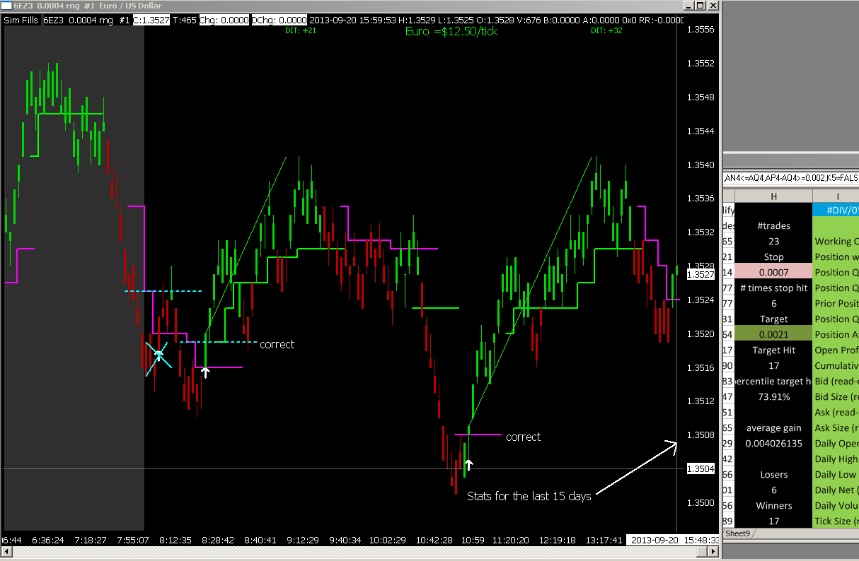

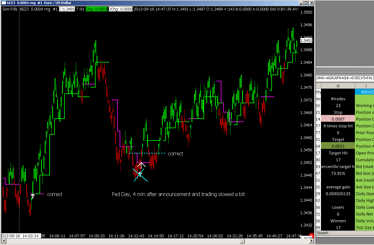

Ok..I'm offering some pix from this last week as a teaser. Examples are using my best attempt to formulate the CBL, which is not entirely correct. White arrows are algorithmically generated,and are longs only..you can eyeball the short potential. CountBackLine has been corrected where appropriate with a blue dash.I've added some other parameters to the trigger equation, like ensuring price is within a 50+ period low, for example...but the CBL is 85% of the guts of the entry.
I'm aware 23 trades "does not a system make", I'd just would love to get this indicator stable so I can start fine tuning the entry equation for stats. Does a 70%+ hit rate risking 90 bucks to make $260, with an average run of $500 interest anybody that can write Ascii? :)
