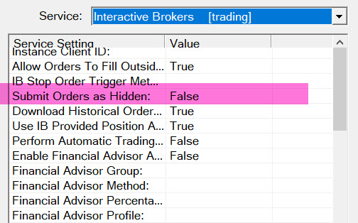

[2017-09-26 17:20:07]
Joe Hobart - Posts: 89
the "submit Orders as Hidden:" IB trading service option had been set to True. I did not make that change intentionally, IB was able to see that flag on the submitted order.
image2017-09-26_13-15-56.jpg / V - Attached On 2017-09-26 17:17:47 UTC - Size: 84.62 KB - 423 views

[2017-09-27 13:21:14]
i checked with a few SC+IB friends, ALL of them had this setting set to true. this should default to FALSE.
[2017-09-27 18:55:01]
In the next release we will reset this back to false. Not totally sure why it would be true because the default is false.
