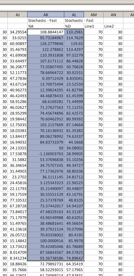

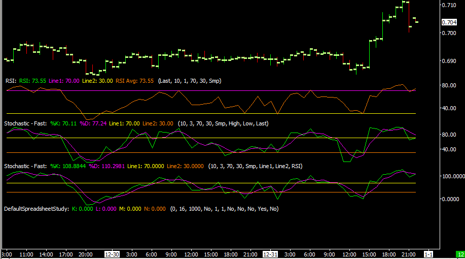

[2013-09-12 19:08:34]
User92573 - Posts: 622
Okay, I'm a little lost and I'd like to clarify things as I'm getting to the end of my trial (4 days left) and so far the people I have spoken to have been very helpful and the software seems excellent.
The point I made was simply that the Stochastic (Raw K in my test) by the nature of its formula will range between 0 and 100, and is a % value which depicts the close in relation to the previous 'n' period HH/LL.
When I substituted another input still a data series (as opposed to the main graph in my test) the values ranged above and below the 0% to 100%. 2 x Screenshots attached.
That was the only point I was making.
I was told that a study could use the value from a previous study.
As I'd hoped to use SC for my presentations (C++ is low level and very robust) the next of which is to 300+ trader as well as in my trading, you can appreciate that I need to understand exactly what I can do; what I cant do; and if the results are as anticipated. This is just being thorough as I cannot stand up and apologise that I'd overlooked or hadn't noticed that 'xyz' was incorrect!
In this test the output confused me so I politely forwarded this to support.
Would it be possible to extend my trial another 7 - 10 days as I have am still working hard to get to grips with the program while managing my current work load?
imageStochastic query 2.PNG / V - Attached On 2013-09-12 19:07:39 UTC - Size: 82.53 KB - 699 views
imageStochastic query 1.PNG / V - Attached On 2013-09-12 19:07:54 UTC - Size: 29.32 KB - 697 views
[2013-09-13 03:12:55]
We can see what the problem is from these images. Otherwise, we would never have known.
The Stochastic study requires three different price inputs. High, Low and Last. For High and Low you are using the two horizontal lines from the RSI. This is not valid. You need to set all three of them to the single RSI Subgraph.
We have given you a trial extension.
