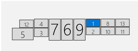

See attached .PNG for my monitor layout. SC main window is running on monitor #1. When I try to detach a chart, it's putting it off the top of monitor #4. Since they both share the same upper boundary, it's hard to attribute this to my configuration, but I suppose anything is possible?

Sorry, new user, thought I attached the .PNG to the last reply but it didn't take. Just did it again, it uploaded ok, but I still don't see it. For now the monitor that SC is running on and the monitor it's trying to put the detached chart on are at the same vertical placement, and share the same upper boundary.
I'll post the .PNG of my screen layout as soon as I figure out what I'm doing wrong with the upload tool.

Ok, screen layout in prior reply. SC is placing windows off the tops of monitors 12 and 4. I have moved the SC main window from monitor 1 to monitors 2, 10, and 11 (on speculation this might have to do with relative coordinates), but no change in behavior.
While the smaller Y-extent to monitor 12 might suggest that could be the problem, monitor 4 has the same top height as all the other monitors, so that seems to disprove the theory. SC is putting both trade windows and detached charts at the top of monitors 4 and 12, with about 2/3 of the window visible and the rest off the top of the screen where I cannot get to its title bar to drag it elsewhere.
