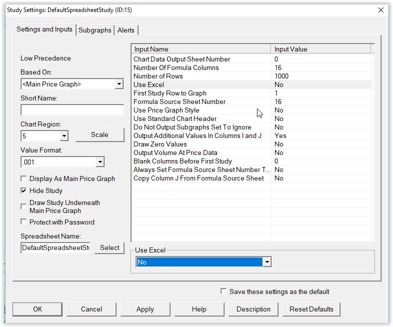

Hi there, does this option work?
Gets to be way easier to work with numbers.
I tried it it continuously open an Excel window after I close it but the worksheets are just blank. Data are not porting over.
imageScreen Shot 09-16-17 at 06.19 PM.PNG / V - Attached On 2017-09-16 22:19:57 UTC - Size: 41.95 KB - 606 views

This is explained here:
https://www.sierrachart.com/index.php?page=doc/SpreadsheetStudyInputs.html#UseExcel
Give us one or two items why it is easier to work with numbers in Excel. And we will see if we can possibly work on one or two of those.
