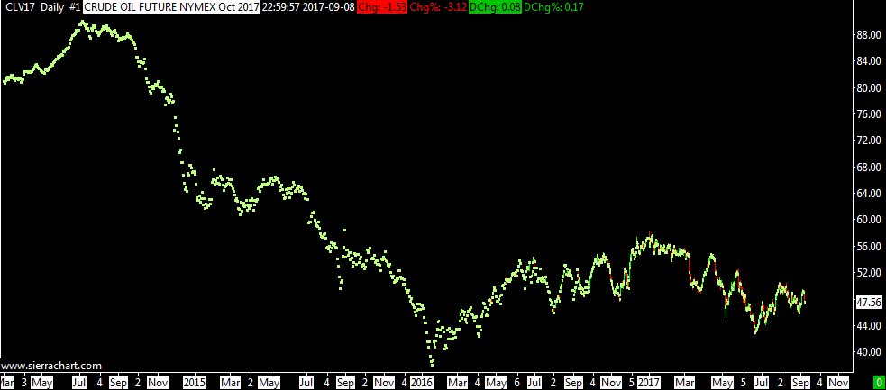

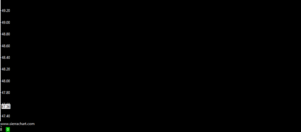

v1607 has a problem with charts drawn to offscreen surfaces. If you load several Chartbooks on startup using "General Settings" -> "File To Load on Startup" ->Add several chartbooks.
The charts that startup off screen will not have any width, the vertical scale axis draws at the far left of the chart window and there are no chart bars. Pressing CTRL-Insert fixes it. (Chart->Recalculate)
I uploaded an image
http://www.sierrachart.com/image.php?Image=150505131152.png
The image chart is a daily historical chart of Crude oil (CLV17) with no studies, it also happens with intraday charts as well. This problem was not evident in v1605.
[2017-09-10 14:00:26]
Sporken - Posts: 82
When I press Chart->Recalculate, it fixes the chart appearance.
http://www.sierrachart.com/image.php?Image=1505051951164.png
[2017-09-10 20:10:38]
We will look into this and resolve it. We will try to duplicate it.
It relates to the new functionality where chart windows are destroyed when they are no longer visible.
