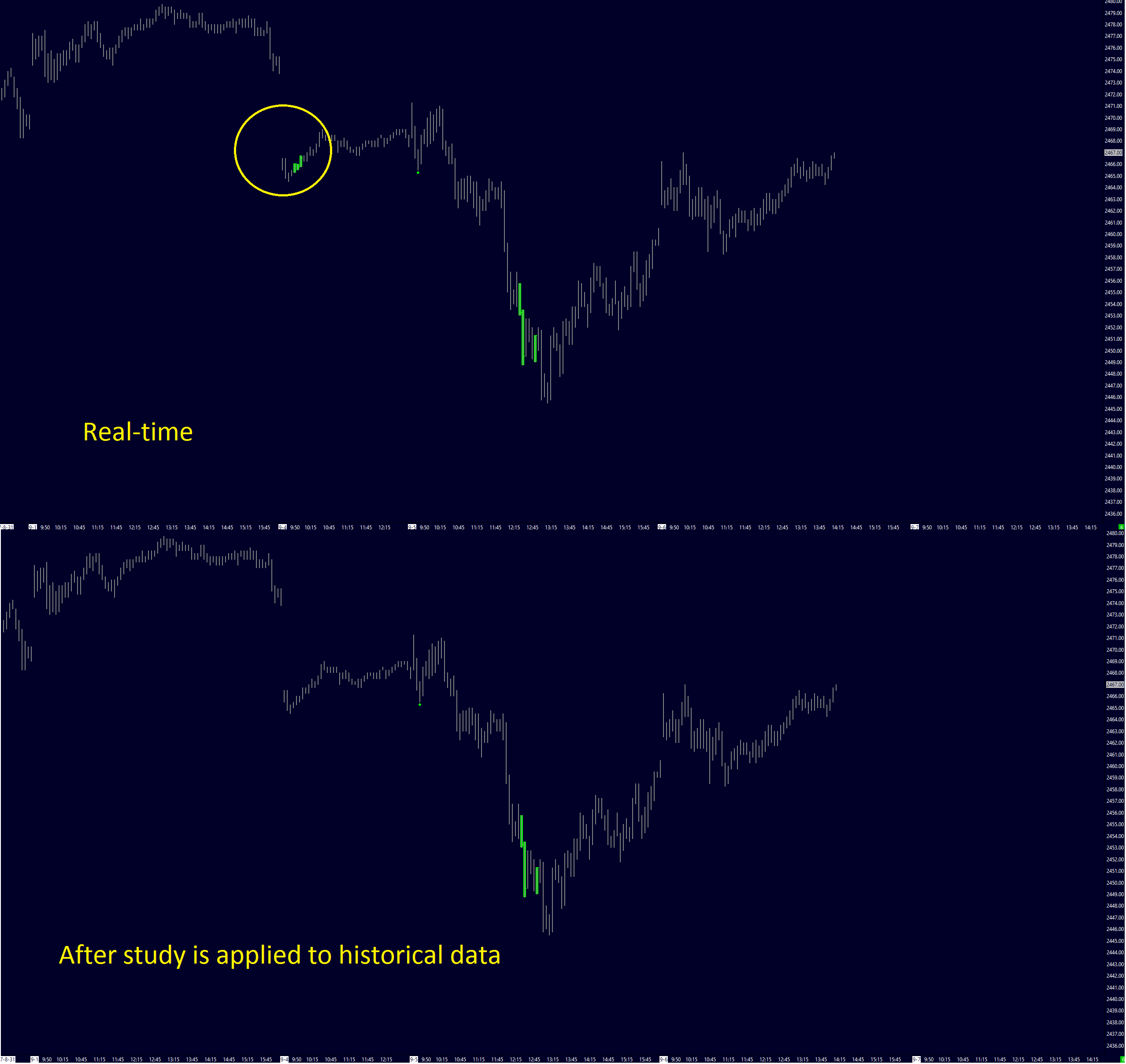

I use a simple alert formula in a color bar study that is based on a study that repaints at each bar, so the color bars in real time are different to those based on historical data.
Is there any solution in ACSIL to not prevent a recalculation happening? Or something so I could freeze or record real time color bar alerts?

See image attached illustrate what i'm referring to.
Color bar alerts are correct based on Real-time data, however, some alerts are not recorded based on historical data( This is to be expected based on my alert conditions).
I want to some how record or store the Real-time alerts, or at least keep them from recalculating so that I would have to remove and re-add the study in order to recalculate.
Is there any potential solution to this?

Possibly you could use the Spreadsheet Study and use this functionality:
Spreadsheet Studies Special Tasks: Locking the State of a One Time Condition
Or use ACSIL and set a persistent variable with the particular alert state for a particular bar index:
ACSIL Interface Members - Functions: sc.GetPersistentInt()

Does this still occur when you have "Evaluate On Bar Close" selected on alert tab?
Yes. What i'm referring to has nothing to do with "Evaluate on Bar Close"
The alert condition involves a rolling window( like a polynomial regression channel), which repaints at each bar. This means that a condition could have been true eg 200 bars ago, however, could appear not to be true based on the last bar- Because historical values of the polynomial regression change at each new bar.
