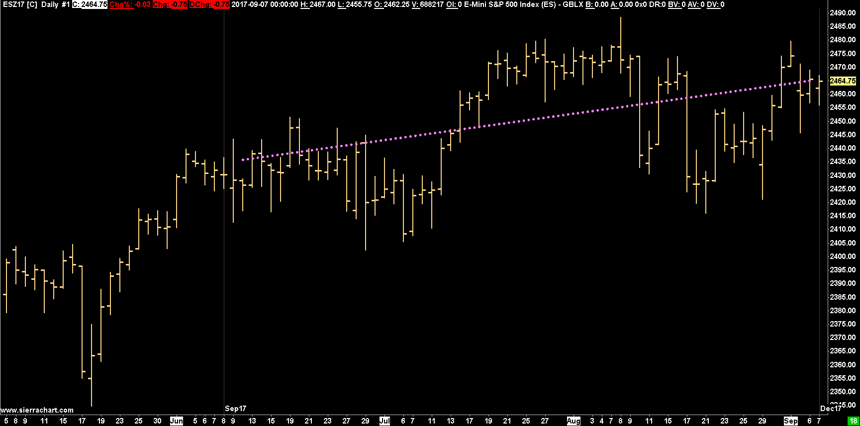

[2017-09-07 21:01:08]
We cannot reproduce what you are describing using a Historical Daily chart. We are certain there is no problem like this. Whatever issue there is must be an isolated case for reasons which are not clear or a misunderstanding.
Here is the chart:
http://www.sierrachart.com/image.php?Image=1504818032594.png
Here is the chart data for the bar mentioned:
Chart Values for Tools
Y: 2392.00
Mon 2017-08-07 00:00:00.000 Bar Begin Time
Region 1
ESZ17 [C] Daily #1 ()
Price Chg: 5.50
Open: 2472.25
High: 2478.25
Low: 2472.00
Last: 2477.50
Volume: 599701
OpenInt: 3053147
OHLC Avg: 2475.00
HLC Avg: 2475.92
HL Avg: 2475.13
Bid Volume: 0
Ask Volume: 0
We bolded the correct high-value.
Date Time Of Last Edit: 2017-09-07 21:01:46
