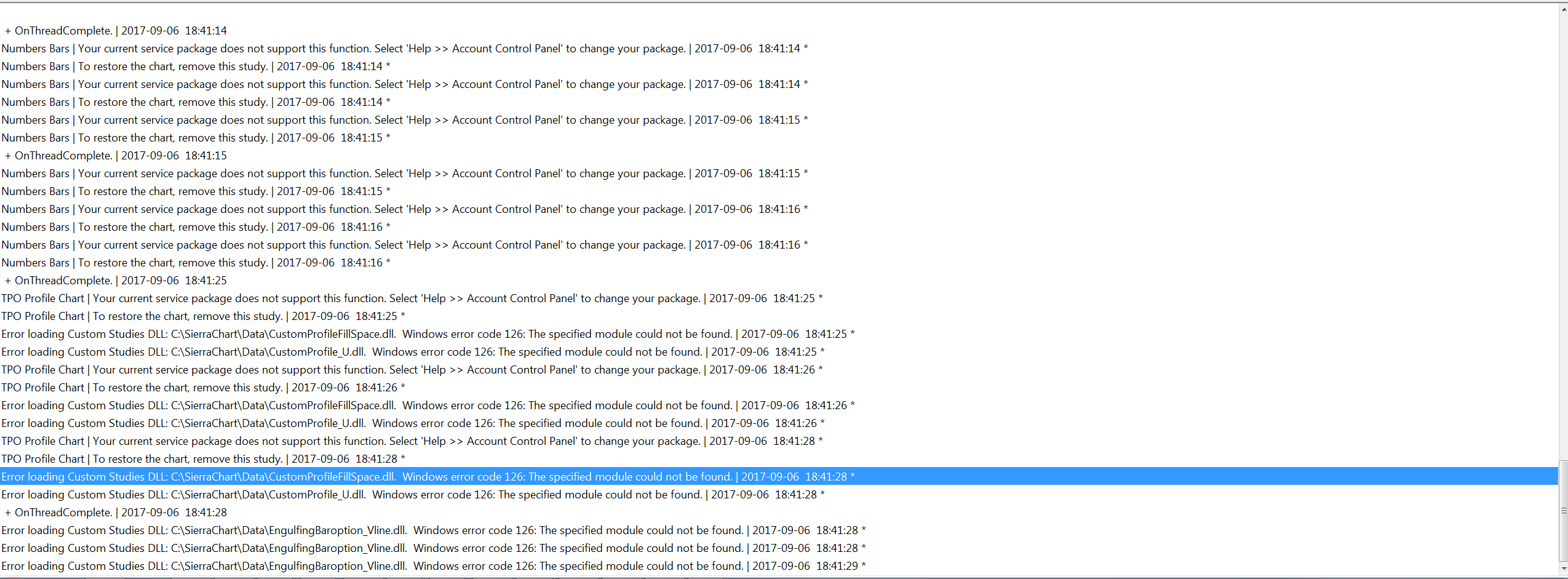

I have also attached the log for your reference for this issue
imagelog.PNG / V - Attached On 2017-09-06 18:42:57 UTC - Size: 142.83 KB - 453 views
[2017-09-06 19:03:36]
We understand what the problem is now. You need to change to service package 5. Follow the instructions below.
To change your Sierra Chart service package, select "Help >> Account Control Panel" on the Sierra Chart program menu. On the displayed webpage, click on "Change Service Package".
The remaining service usage time on your account will be adjusted based upon the cost of the package you are changing to. If the new package is a higher-priced package, then the usage time will be reduced due to the higher price.
There is no charge for changing your Sierra Chart service package. Only your Sierra Chart account usage time ending date is adjusted.
