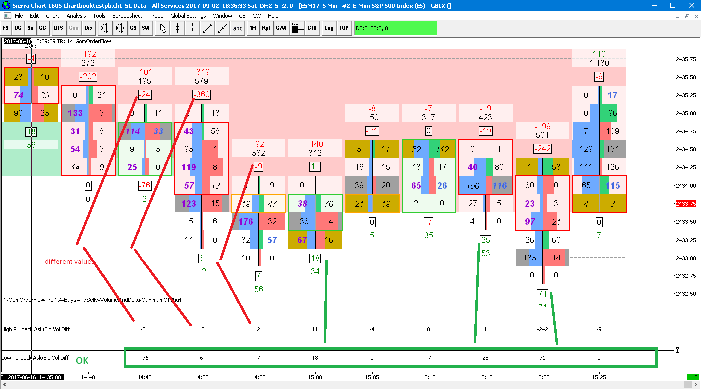

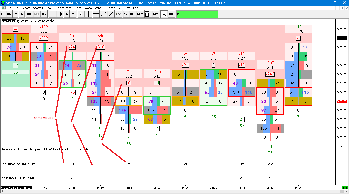

It was OK in 1587, wrong in 1605, I think also in 1590.
The Low Pullback Ask/Bid Vol Diff is OK.
imagesierrabadcot.png / V - Attached On 2017-09-02 16:44:04 UTC - Size: 75.22 KB - 632 views
imagesierragoodcot2.png / V - Attached On 2017-09-02 16:46:20 UTC - Size: 48.36 KB - 530 views

We have spent some time on this and we realize the way that you are presenting this is very unclear.
It looks as though you are comparing the High Pullback Ask volume Bid volume difference, to your own study. How do you know your own study is correct?
We see no reason why there would be any problem with these calculations in Sierra Chart especially being you are not seeing any issue with the low pullback calculation which follows the same method as the high pullback other than resetting on a low rather than a high.

I posted the same chart, from the exact same bars, from SC1587 and SC1605
The Low Pullback numbers match between the 2 versions, not the High Pullback.
So something did happen on the High Pullback.

What time zone is that chart set to?
And is the data file using tick by tick data?
[2017-09-05 17:08:24]
gomifromparis - Posts: 244
Paris Time (GMT+2)
Yes it's one tick.
[2017-09-05 18:01:59]
Rithmic data.
By the way my NinjaTrader8 version using a manual tick by tick calculation matches the SC1587 numbers.
[2017-09-06 00:24:12]
We found the problem and fixed it.
