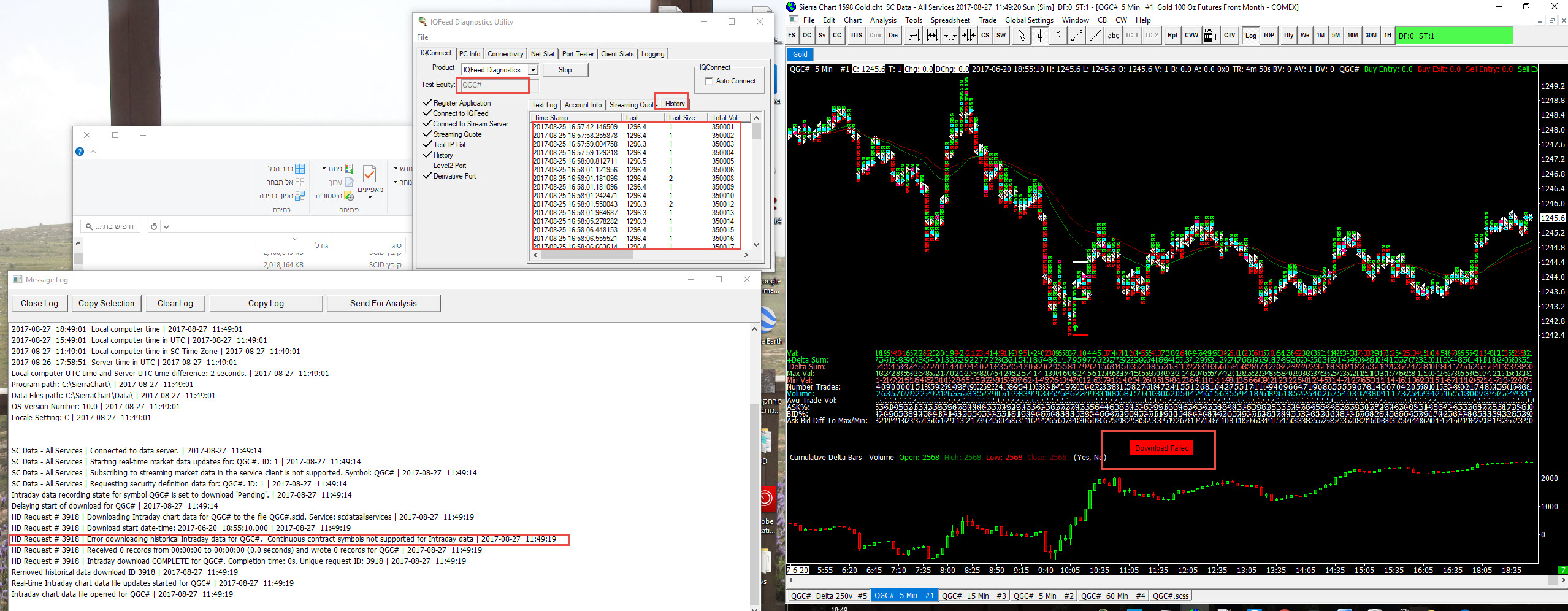

[2017-08-27 16:01:24]
User61576 - Posts: 458
hi
thanks for your support but i did follow this instruction guide few years back and nothing changed.
in fact i had no issue till today with this for the last few years
regular symbols are being downloaded by SC with no problem (maft, amzn etc.)
yet, continues futures have a problem
as you can see from the attached screenshot, the iqfeed diagnostic tool is showing the history data for the same symbol (QGC#) as in SC but SC is failing to get the data
this applies to all @ES#,@NE# etc.
so there is no problem with iqfeed but only with SC
pls re advice
thanks
image2017-08-27_18-49-34.jpg / V - Attached On 2017-08-27 15:53:25 UTC - Size: 1.02 MB - 459 views
