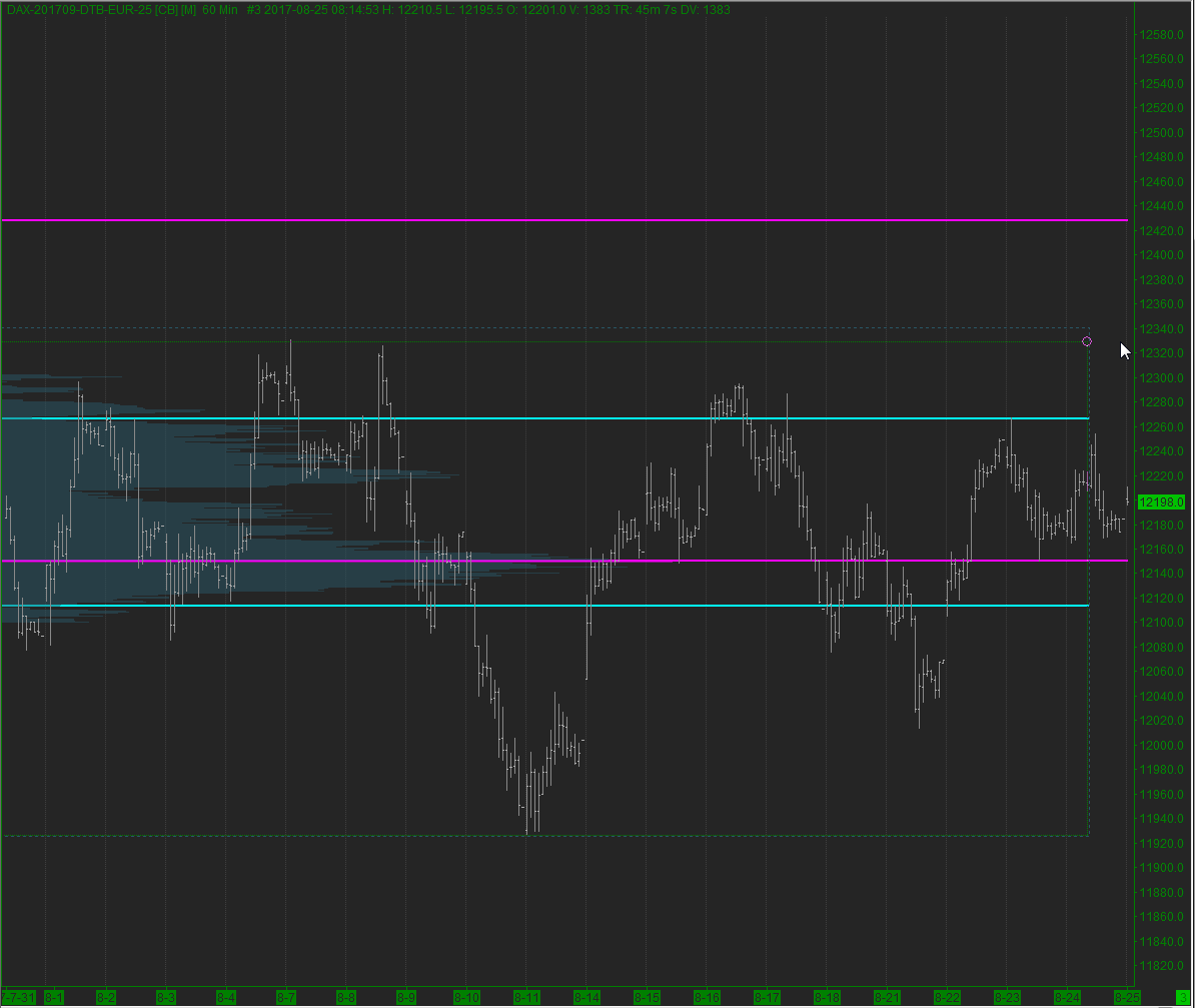

Two screenshots here. I've included the mouse pointer in each screenshot. Screen one is my selecting the right edge of this profile and moving it forward to new bars. You can see the pointer is matching the profile outline.
The second shot is me doing the same thing, except I wait a short period of time while still having the profile selected for moving. This pulls the selected profile back to its original anchors, regardless of where my mouse is. I don't know whats causing it, it could be a price change, or a new tick forcing a redraw of the indicator or something.
When the market is busy, it can be virtually impossible for me to resize an already drawn profile.

When you observe this, as you are adjusting the Volume Profile, do you see the volume bars of that profile change to match the new selected ending Date-Time even before you left click again to permanently set the new ending Date-Time?
You should. If not, this would indicate why the problem is happening.
[2017-08-28 06:10:23]
User19165 - Posts: 346
No, the volume bars remain unchanged while I am in the process of adjusting.
As I move the profile to new bars before left clicking to set the profile at the new position. The profile will snap back on what looks like a new tick or a price change. I can keep moving my mouse to new bars and the profile will follow it, but it will snap back frequently when I pause moving the mouse when an event happens. If you click after it has snapped back, the profile remains at its old position and without any change to the profile. If by chance, you are able to select the profile, move to new location and click to set the profile at a new bar before it snaps back - then of course it is fine.

This is not normal and is not something that other users would experience in usual cases. The Volume Profile should automatically adjust as you move it.

Actually we just realized why this happens. You need to adjust the Volume Profile rectangle, from other than at a location than the corners.

It will be supported in the next release to adjust a drawn Volume Profile at the corners and have it automatically update as you adjust it.

Confirmed it is the corner grab that causes the problem. Because when you click the profile, the 2 corner anchors highlight, it never even occurred to me to grab anywhere other than the corner anchors...Even without the next release its nice to finally get past this problem. Thank you.
