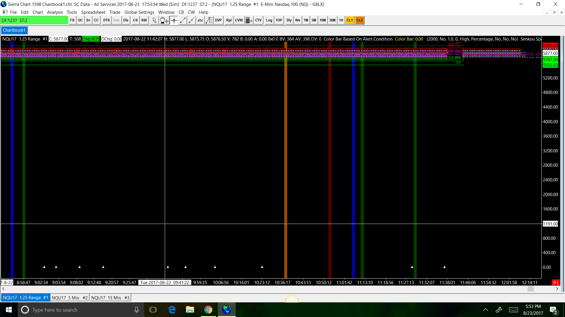

I'm having an issue with using the color bar based on alert condition when trying to use any type of symbol (triange, arrow, star) anything besides coloring the bar causes the chart itself to become smashed at the top and the symbol appears at the bottom... I've attached a pic.
I have made sure that region 1 is selected, tried checking the display beneath chart, tried different symbols, different alert conditions... can not figure out what is causing this. Also tried on a fresh new chart...
imageScreenshot (1).png / V - Attached On 2017-08-24 01:01:59 UTC - Size: 132.14 KB - 512 views
[2017-08-24 04:56:38]
You need to follow through the instructions here for this:
Color Bar Based on Alert Condition: Drawing Arrows/Text or Other Styles at the High or Low of Bars
