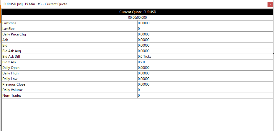

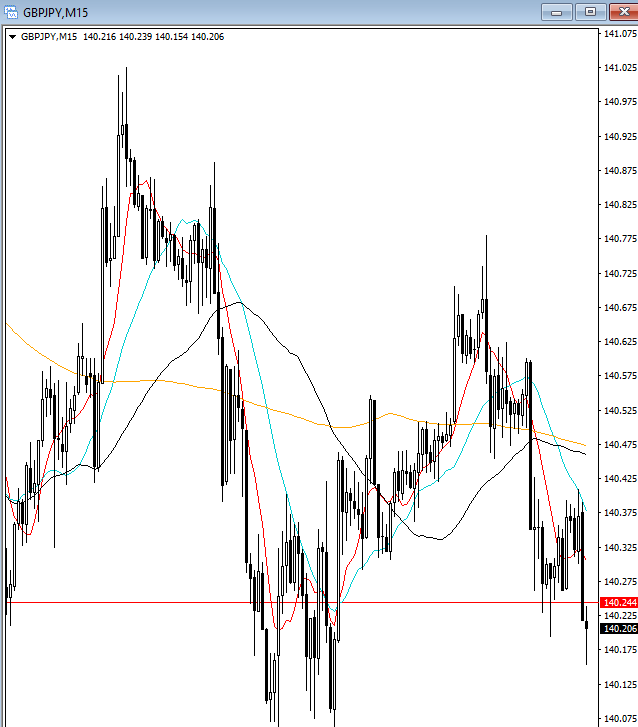

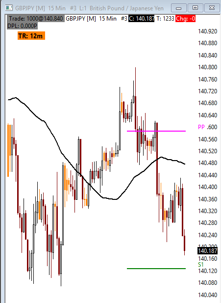

I have the SC Data - All Services Service chosen, and normally I have no issues, but this morning the FX is not updating in real time. Specifically I was looking at GBPUSD and also EURUSD.
Are you aware of any issues with this currently please?
When I close and reopen prices catches up and the bars update but it is definitely not updating in real time.
imageSC 2017-08-23_07-22-10.png / V - Attached On 2017-08-23 06:24:36 UTC - Size: 23.79 KB - 407 views
imageMT4 2017-08-23_07-22-10.png / V - Attached On 2017-08-23 06:24:40 UTC - Size: 25.84 KB - 426 views

HD Request # 8 | Daily download COMPLETE for EURUSD. Completion time: 0s. Unique request ID: 7 | 2017-08-24 07:08:11
Removed historical data download ID 7 | 2017-08-24 07:08:11
HD Request # 9 | Downloading Historical Daily chart data for USDJPY. Starting date: 2017-08-22. Service: DTCSubInstance | 2017-08-24 07:08:11
HD Request # 9 | Using server: 127.0.0.1 port 11098 | 2017-08-24 07:08:11
Socket (13) | Creating socket. | 2017-08-24 07:08:11
Socket (13) | Connecting to IP: 127.0.0.1. | 2017-08-24 07:08:11
HD Request # 9 | Setting DTC encoding to Binary VLS | 2017-08-24 07:08:11
HD Request # 9 | Sending historical data logon request message. | 2017-08-24 07:08:11
HD Request # 9 | Requesting historical Daily data starting at 2017-08-22. | 2017-08-24 07:08:11
HD Request # 9 | Data is being downloaded from a remote source. Download will start when this is done. | 2017-08-24 07:08:11
EURUSD [M] Daily #4 | Reloading chart. | 2017-08-24 07:08:11
EURUSD [M] Weekly #8 | Reloading chart. | 2017-08-24 07:08:11
EURUSD [M] Daily #7 | Reloading chart. | 2017-08-24 07:08:11
EURUSD [M] Weekly #1 | Reloading chart. | 2017-08-24 07:08:11
EURUSD [M] Daily #6 | Reloading chart. | 2017-08-24 07:08:11
Chart #7 has tagged chart #1 for full recalculation. Chartbook: Intraday FX.cht | 2017-08-24 07:08:11
Chart #7 has tagged chart #2 for full recalculation. Chartbook: Intraday FX.cht | 2017-08-24 07:08:11
Chart #7 has tagged chart #3 for full recalculation. Chartbook: Intraday FX.cht | 2017-08-24 07:08:11
Chart #7 has tagged chart #6 for full recalculation. Chartbook: Intraday FX.cht | 2017-08-24 07:08:11
EURUSD [M] 120 Min #6 | Performing a full recalculation because it has been tagged. Chartbook: Intraday FX.cht | 2017-08-24 07:08:11
EURUSD [M] 15 Min #3 | Performing a full recalculation because it has been tagged. Chartbook: Intraday FX.cht | 2017-08-24 07:08:11
EURUSD [M] 240 Min #1 | Performing a full recalculation because it has been tagged. Chartbook: Intraday FX.cht | 2017-08-24 07:08:11
EURUSD [M] 60 Min #2 | Performing a full recalculation because it has been tagged. Chartbook: Intraday FX.cht | 2017-08-24 07:08:11
HD Request # 9 | Decompressing data. | 2017-08-24 07:08:12
HD Request # 9 | Receiving historical Daily data for USDJPY starting at 2017-08-22 | 2017-08-24 07:08:12
HD Request # 9 | Writing historical Daily data to the file USDJPY.dly | 2017-08-24 07:08:12
Socket (13) | Initiating close of socket by core. | 2017-08-24 07:08:12
Socket (13) | Shutdown started. Waiting for graceful close. | 2017-08-24 07:08:12
Socket (13) | Socket gracefully closed by remote side. | 2017-08-24 07:08:12
Socket (13) | Closed. | 2017-08-24 07:08:12
Historical data download thread signaled to stop. | 2017-08-24 07:08:12
HD Request # 9 | Received 3 records from 2017-08-22 00:00:00 to 2017-08-24 00:00:00 (3.0 days) and wrote 3 records for USDJPY | 2017-08-24 07:08:12
HD Request # 9 | Daily download COMPLETE for USDJPY. Completion time: 1s. Unique request ID: 8 | 2017-08-24 07:08:12
Removed historical data download ID 8 | 2017-08-24 07:08:12
Delaying start of download for EURUSD | 2017-08-24 07:08:12
USDJPY [M] Daily #7 | Reloading chart. | 2017-08-24 07:08:12
HD Request # 10 | Downloading Intraday chart data for EURUSD to the file EURUSD.scid. Service: DTCSubInstance | 2017-08-24 07:08:22
HD Request # 10 | Download start date-time: 2017-08-23 07:25:00.000 | 2017-08-24 07:08:22
HD Request # 10 | Using server: 127.0.0.1 port 11098 | 2017-08-24 07:08:22
Socket (14) | Creating socket. | 2017-08-24 07:08:22
Socket (14) | Connecting to IP: 127.0.0.1. | 2017-08-24 07:08:22
HD Request # 10 | Setting DTC encoding to Binary VLS | 2017-08-24 07:08:22
HD Request # 10 | Sending historical data logon request message. | 2017-08-24 07:08:22
HD Request # 10 | Requesting Intraday data. Start date-time: 2017-08-23 07:25:00. Record interval: 5. Symbol: EURUSD | 2017-08-24 07:08:22
HD Request # 10 | Data is being downloaded from a remote source. Download will start when this is done. | 2017-08-24 07:08:22
DTC Client (7) | Connect event error. Windows error code 10060: A connection attempt failed because the connected party did not properly respond after a period of time, or established connection failed because connected host has failed to respond. | 2017-08-24 07:08:23 *
DTC Client (7) | Initiating close of socket by core. | 2017-08-24 07:08:23
DTC Client (7) | Closed. | 2017-08-24 07:08:23
FXCM FIX Trading | Disconnected from the server. | 2017-08-24 07:08:23
FXCM FIX Trading | Data feed disconnected. Will reconnect in 2 seconds. | 2017-08-24 07:08:23
FXCM FIX Trading | Connecting to the server ds5.sierracharts.com. Port 10048 | 2017-08-24 07:08:25
DTC Client (15) | Creating socket. | 2017-08-24 07:08:25
DTC Client (15) | Connecting to IP: 204.15.192.106. | 2017-08-24 07:08:25
HD Request # 10 | Decompressing data. | 2017-08-24 07:08:28
HD Request # 10 | Receiving Intraday data for EURUSD starting at 2017-08-23 07:25:00 | 2017-08-24 07:08:28
HD Request # 10 | Timestamp of first Intraday data file record written: 2017-08-23 07:25:00 | 2017-08-24 07:08:28
Socket (14) | Initiating close of socket by core. | 2017-08-24 07:08:28
Socket (14) | Shutdown started. Waiting for graceful close. | 2017-08-24 07:08:28
Socket (14) | Socket gracefully closed by remote side. | 2017-08-24 07:08:28
Historical data download thread signaled to stop. | 2017-08-24 07:08:28
Socket (14) | Closed. | 2017-08-24 07:08:28
HD Request # 10 | Received 1423 records from 2017-08-23 07:25:00 to 2017-08-24 07:08:00 (23.7 hours) and wrote 1423 records for EURUSD | 2017-08-24 07:08:28
HD Request # 10 | Intraday download COMPLETE for EURUSD. Completion time: 6s. Unique request ID: 9 | 2017-08-24 07:08:28
Removed historical data download ID 9 | 2017-08-24 07:08:28
Real-time Intraday chart data file updates started for EURUSD | 2017-08-24 07:08:28
Opened cached Intraday file: C:\Users\RBT-Desktop\Documents\SierraChart_EOD\SierraChartInstance_2\Data\EURUSD.scid | 2017-08-24 07:08:28
Intraday chart data file opened for EURUSD | 2017-08-24 07:08:28
Delaying start of download for GBPUSD | 2017-08-24 07:08:28
HD Request # 11 | Downloading Intraday chart data for GBPUSD to the file GBPUSD.scid. Service: DTCSubInstance | 2017-08-24 07:08:38
HD Request # 11 | Download start date-time: 2017-08-23 07:26:00.000 | 2017-08-24 07:08:38
HD Request # 11 | Using server: 127.0.0.1 port 11098 | 2017-08-24 07:08:38
Socket (16) | Creating socket. | 2017-08-24 07:08:38
Socket (16) | Connecting to IP: 127.0.0.1. | 2017-08-24 07:08:38
HD Request # 11 | Setting DTC encoding to Binary VLS | 2017-08-24 07:08:38
HD Request # 11 | Sending historical data logon request message. | 2017-08-24 07:08:38
HD Request # 11 | Requesting Intraday data. Start date-time: 2017-08-23 07:26:00. Record interval: 5. Symbol: GBPUSD | 2017-08-24 07:08:38
HD Request # 11 | Data is being downloaded from a remote source. Download will start when this is done. | 2017-08-24 07:08:38
HD Request # 11 | Decompressing data. | 2017-08-24 07:08:39
HD Request # 11 | Receiving Intraday data for GBPUSD starting at 2017-08-23 07:26:00 | 2017-08-24 07:08:39
HD Request # 11 | Timestamp of first Intraday data file record written: 2017-08-23 07:26:00 | 2017-08-24 07:08:39
Socket (16) | Initiating close of socket by core. | 2017-08-24 07:08:39
Socket (16) | Shutdown started. Waiting for graceful close. | 2017-08-24 07:08:39
Socket (16) | Socket gracefully closed by remote side. | 2017-08-24 07:08:39
Historical data download thread signaled to stop. | 2017-08-24 07:08:39
Socket (16) | Closed. | 2017-08-24 07:08:39
HD Request # 11 | Received 1408 records from 2017-08-23 07:26:00 to 2017-08-24 07:08:02 (23.7 hours) and wrote 1408 records for GBPUSD | 2017-08-24 07:08:39
HD Request # 11 | Intraday download COMPLETE for GBPUSD. Completion time: 1s. Unique request ID: 10 | 2017-08-24 07:08:39
Removed historical data download ID 10 | 2017-08-24 07:08:39
Real-time Intraday chart data file updates started for GBPUSD | 2017-08-24 07:08:39
Opened cached Intraday file: C:\Users\RBT-Desktop\Documents\SierraChart_EOD\SierraChartInstance_2\Data\GBPUSD.scid | 2017-08-24 07:08:39
Intraday chart data file opened for GBPUSD | 2017-08-24 07:08:39
Delaying start of download for USDCAD | 2017-08-24 07:08:39
DTC Client (15) | Connect event error. Windows error code 10060: A connection attempt failed because the connected party did not properly respond after a period of time, or established connection failed because connected host has failed to respond. | 2017-08-24 07:08:46 *
DTC Client (15) | Initiating close of socket by core. | 2017-08-24 07:08:46
DTC Client (15) | Closed. | 2017-08-24 07:08:46
FXCM FIX Trading | Disconnected from the server. | 2017-08-24 07:08:46
FXCM FIX Trading | Data feed disconnected. Will reconnect in 2 seconds. | 2017-08-24 07:08:46
FXCM FIX Trading | Connecting to the server ds5.sierracharts.com. Port 443 | 2017-08-24 07:08:48
DTC Client (17) | Creating socket. | 2017-08-24 07:08:48
DTC Client (17) | Connecting to IP: 204.15.192.106. | 2017-08-24 07:08:48
HD Request # 12 | Downloading Intraday chart data for USDCAD to the file USDCAD.scid. Service: DTCSubInstance | 2017-08-24 07:08:49
HD Request # 12 | Download start date-time: 2017-08-23 07:26:02.000 | 2017-08-24 07:08:49
HD Request # 12 | Using server: 127.0.0.1 port 11098 | 2017-08-24 07:08:49
Socket (18) | Creating socket. | 2017-08-24 07:08:49
Socket (18) | Connecting to IP: 127.0.0.1. | 2017-08-24 07:08:49
HD Request # 12 | Setting DTC encoding to Binary VLS | 2017-08-24 07:08:49
HD Request # 12 | Sending historical data logon request message. | 2017-08-24 07:08:49
HD Request # 12 | Requesting Intraday data. Start date-time: 2017-08-23 07:26:02. Record interval: 5. Symbol: USDCAD | 2017-08-24 07:08:49
HD Request # 12 | Data is being downloaded from a remote source. Download will start when this is done. | 2017-08-24 07:08:49
HD Request # 12 | Decompressing data. | 2017-08-24 07:08:56
HD Request # 12 | Receiving Intraday data for USDCAD starting at 2017-08-23 07:26:02 | 2017-08-24 07:08:56
HD Request # 12 | Timestamp of first Intraday data file record written: 2017-08-23 07:26:02 | 2017-08-24 07:08:56
Socket (18) | Initiating close of socket by core. | 2017-08-24 07:08:56
Socket (18) | Shutdown started. Waiting for graceful close. | 2017-08-24 07:08:56
Socket (18) | Socket gracefully closed by remote side. | 2017-08-24 07:08:56
Historical data download thread signaled to stop. | 2017-08-24 07:08:56
Socket (18) | Closed. | 2017-08-24 07:08:56
HD Request # 12 | Received 1412 records from 2017-08-23 07:26:02 to 2017-08-24 07:08:00 (23.7 hours) and wrote 1412 records for USDCAD | 2017-08-24 07:08:56
HD Request # 12 | Intraday download COMPLETE for USDCAD. Completion time: 7s. Unique request ID: 11 | 2017-08-24 07:08:56
Removed historical data download ID 11 | 2017-08-24 07:08:56
Real-time Intraday chart data file updates started for USDCAD | 2017-08-24 07:08:56
Opened cached Intraday file: C:\Users\RBT-Desktop\Documents\SierraChart_EOD\SierraChartInstance_2\Data\USDCAD.scid | 2017-08-24 07:08:56
Intraday chart data file opened for USDCAD | 2017-08-24 07:08:56
Delaying start of download for EURGBP | 2017-08-24 07:08:56
HD Request # 13 | Downloading Intraday chart data for EURGBP to the file EURGBP.scid. Service: DTCSubInstance | 2017-08-24 07:09:06
HD Request # 13 | Download start date-time: 2017-08-23 07:25:04.000 | 2017-08-24 07:09:06
HD Request # 13 | Using server: 127.0.0.1 port 11098 | 2017-08-24 07:09:06
Socket (19) | Creating socket. | 2017-08-24 07:09:06
Socket (19) | Connecting to IP: 127.0.0.1. | 2017-08-24 07:09:06
HD Request # 13 | Setting DTC encoding to Binary VLS | 2017-08-24 07:09:06
HD Request # 13 | Sending historical data logon request message. | 2017-08-24 07:09:06
HD Request # 13 | Requesting Intraday data. Start date-time: 2017-08-23 07:25:04. Record interval: 5. Symbol: EURGBP | 2017-08-24 07:09:06
HD Request # 13 | Data is being downloaded from a remote source. Download will start when this is done. | 2017-08-24 07:09:06
DTC Client (17) | Connect event error. Windows error code 10060: A connection attempt failed because the connected party did not properly respond after a period of time, or established connection failed because connected host has failed to respond. | 2017-08-24 07:09:09 *
DTC Client (17) | Initiating close of socket by core. | 2017-08-24 07:09:09
DTC Client (17) | Closed. | 2017-08-24 07:09:09
FXCM FIX Trading | Disconnected from the server. | 2017-08-24 07:09:09
FXCM FIX Trading | Data feed disconnected. Will reconnect in 2 seconds. | 2017-08-24 07:09:09
FXCM FIX Trading | Connecting to the server ds5.sierracharts.com. Port 10048 | 2017-08-24 07:09:11
DTC Client (20) | Creating socket. | 2017-08-24 07:09:11
DTC Client (20) | Connecting to IP: 204.15.192.106. | 2017-08-24 07:09:11
HD Request # 13 | Decompressing data. | 2017-08-24 07:09:12
HD Request # 13 | Receiving Intraday data for EURGBP starting at 2017-08-23 07:25:04 | 2017-08-24 07:09:12
HD Request # 13 | Timestamp of first Intraday data file record written: 2017-08-23 07:25:04 | 2017-08-24 07:09:12
Socket (19) | Initiating close of socket by core. | 2017-08-24 07:09:12
Socket (19) | Shutdown started. Waiting for graceful close. | 2017-08-24 07:09:12
Socket (19) | Socket gracefully closed by remote side. | 2017-08-24 07:09:12
Socket (19) | Closed. | 2017-08-24 07:09:12
Historical data download thread signaled to stop. | 2017-08-24 07:09:12
HD Request # 13 | Received 1411 records from 2017-08-23 07:25:04 to 2017-08-24 07:09:00 (23.7 hours) and wrote 1411 records for EURGBP | 2017-08-24 07:09:12
HD Request # 13 | Intraday download COMPLETE for EURGBP. Completion time: 6s. Unique request ID: 12 | 2017-08-24 07:09:12
Removed historical data download ID 12 | 2017-08-24 07:09:12
Real-time Intraday chart data file updates started for EURGBP | 2017-08-24 07:09:12
Opened cached Intraday file: C:\Users\RBT-Desktop\Documents\SierraChart_EOD\SierraChartInstance_2\Data\EURGBP.scid | 2017-08-24 07:09:12
Intraday chart data file opened for EURGBP | 2017-08-24 07:09:12
Delaying start of download for EURJPY | 2017-08-24 07:09:12
HD Request # 14 | Downloading Intraday chart data for EURJPY to the file EURJPY.scid. Service: DTCSubInstance | 2017-08-24 07:09:22
HD Request # 14 | Download start date-time: 2017-08-23 07:26:01.000 | 2017-08-24 07:09:22
HD Request # 14 | Using server: 127.0.0.1 port 11098 | 2017-08-24 07:09:22
Socket (21) | Creating socket. | 2017-08-24 07:09:22
Socket (21) | Connecting to IP: 127.0.0.1. | 2017-08-24 07:09:22
HD Request # 14 | Setting DTC encoding to Binary VLS | 2017-08-24 07:09:22
HD Request # 14 | Sending historical data logon request message. | 2017-08-24 07:09:22

This problem still exists unfortunately.
EDIT: I have attached the Current Quote Window as per your Link 1 Troubleshooting. They are all Zeros.

[2017-08-24 11:36:22]
Global Symbol Settings: Update Symbol Settings
This will resolve the issue.
There is an incorrect server address being used because that was inadvertently set in the Symbol Settings released about a week ago for the Forex symbols. This was corrected.
FXCM FIX Trading | Connecting to the server ds5.sierracharts.com. Port 10048 | 2017-08-24 07:10:20
Make sure you do this for each instance of Sierra Chart you are running.
