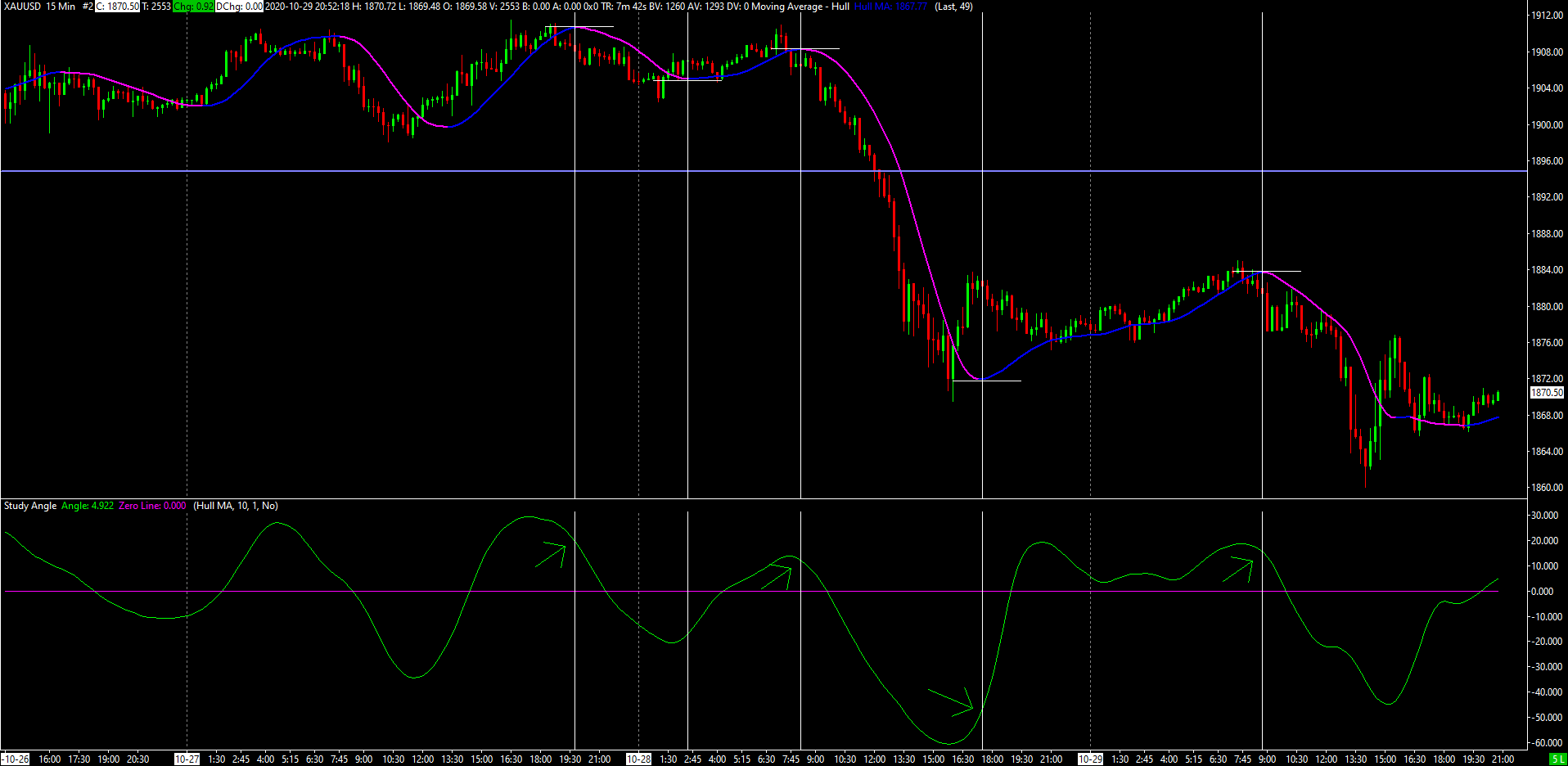

I am trying to use the Study Angle, I expect when the direction of a MA changes (up or down) the Angle(SG1) of the study will pass the Zero line(SG2), ie. the angle of the MA is zero, that is not what I am getting. In the attached screenshot I have a Hull MA and the Study Angle, the SG1 of the Angle does not reflect directly the real angle of the MA relative to the zero line.
http://www.sierrachart.com/image.php?Image=1604005854808.png

What you are describing is not the way this works. What you are describing is actually the derivative of the study at that point. This study uses the Length Input to create a line and determine the slope of that line between the two points. Refer to the information here:
Study Angle

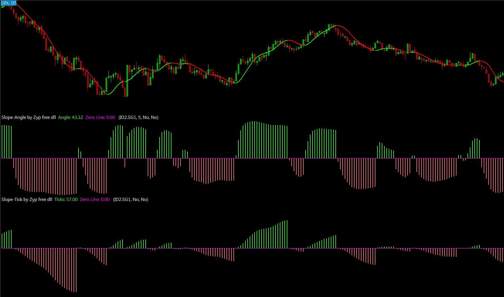

Ackin - Posts: 1866
User854674)
Custom Studies: Slope Tick / Slope Angle
imageSlope tick angle.png / V - Attached On 2020-10-30 17:59:28 UTC - Size: 25.7 KB - 1201 views

AwsM. - Posts: 4
John - SC Support
Thank you. I changed the length to 1 and it gave me what I want.
