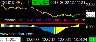

[2013-03-22 16:47:40]
pismo10 - Posts: 171
Before...
imageQCLK13 49 vol #4 41355.6974.png / V - Attached On 2013-03-22 16:47:36 UTC - Size: 10.61 KB - 1287 views

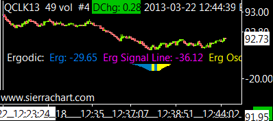

[2013-03-22 16:48:18]
After...Got in now..?
imageQCLK13 49 vol #4 41355.6977.png / V - Attached On 2013-03-22 16:48:13 UTC - Size: 9.99 KB - 1270 views
[2013-03-22 17:09:11]
This does not make sense. You should not see this as long as you have selected Chart >> Reset Scales , have not altered the scale of that Study manually, and you have confirmed that the Scale Range for the study itself and no other study, is set to Automatic.
Refer to this documentation to access the Study Settings for the study itself:
http://www.sierrachart.com/index.php?l=doc/doc_ChartStudies.html#QuickAccess

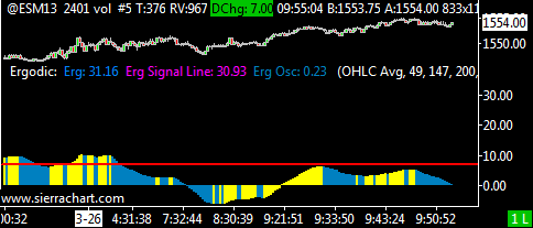

[2013-03-26 13:59:49]
So this is what I get with "Reset Scales" NIce and it stays put but it is way off center with lots of wasted space above. If I center it manually then in a few miutes it will again wander off the screen. Thoughts?
image@ESM13 2401 vol #5 41359.5799.png / V - Attached On 2013-03-26 13:58:52 UTC - Size: 12.46 KB - 1262 views
[2013-03-26 14:27:22]
Either there is another study in that chart region or you still have not set the Scale for the study itself to Automatic. Please post the Chartbook, by following these steps:
https://www.sierrachart.com/index.php?l=PostingInformation.php#AttachFile
[2013-03-26 15:47:30]
Yes!, that is the answer to the whole problem. Lines that are not drawn are effecting the scale. Anyway to stop that and only have it scale based on what is drawn?
[2013-03-26 15:59:13]
What do you mean by "lines that are not drawn"?
Date Time Of Last Edit: 2013-03-26 15:59:28
[2013-03-26 16:37:01]
Well...Ergodic is made of three pieces Erg, Erg Signal line, and Erg Oscillator. I only draw the last one. The first two use the draw style "Do Not Draw" so they do not clutter up my chart.
[2013-03-26 17:32:14]
Set the Subgraph Draw Style for lines which you do not want to see to "Ignore".
Date Time Of Last Edit: 2013-03-28 16:24:22
