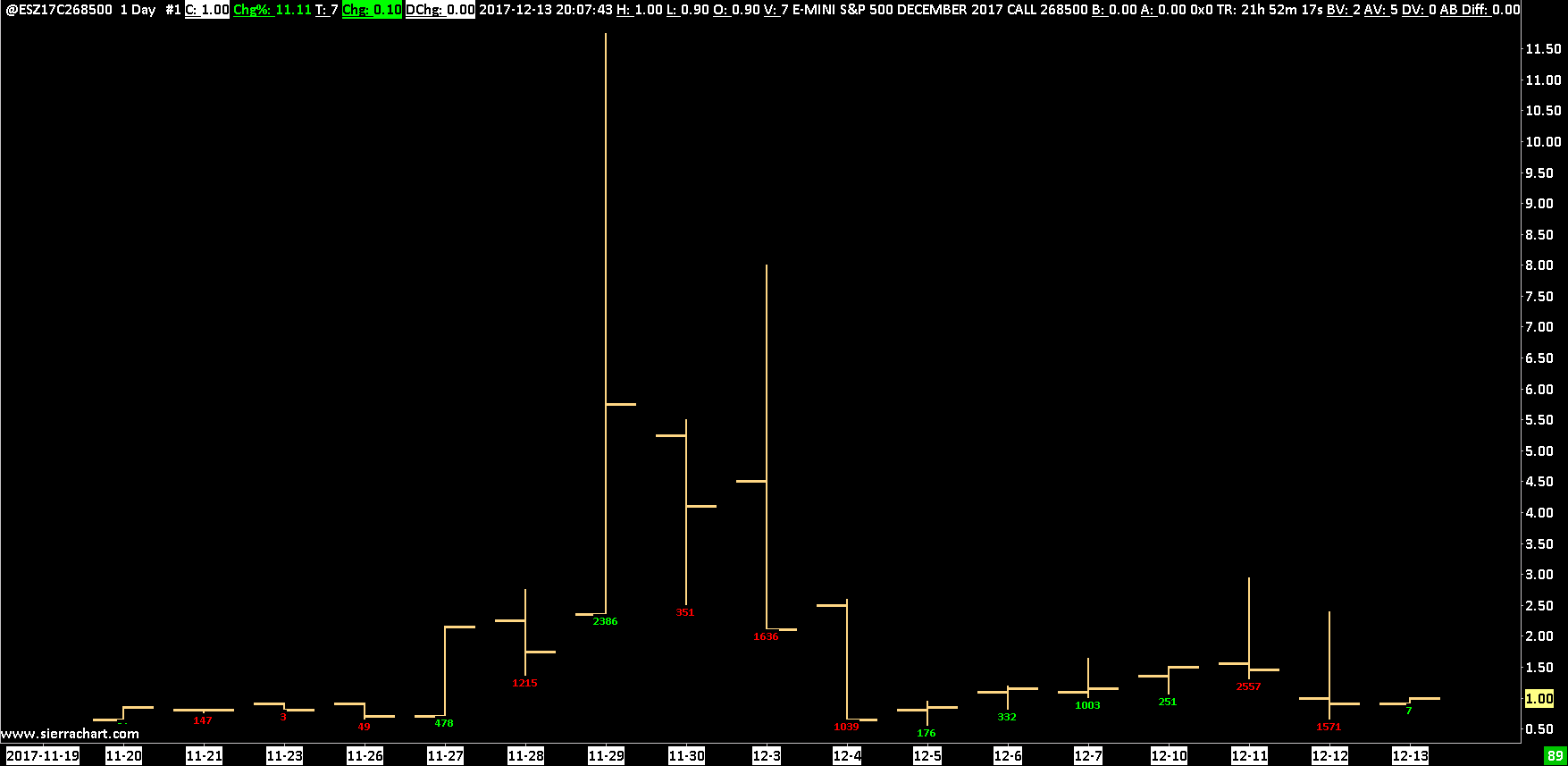

Here is the data from IQ Feed:
http://www.sierrachart.com/image.php?Image=1513214466134.png
These bars are set to start at 18:00:00 US Eastern time.
Therefore our statement that the type of comparison you are making is not valid is correct.
We will not comment on this further. Contact the exchange. This is their responsibility to help you. Not ours.
Date Time Of Last Edit: 2017-12-14 01:22:05

The volume we see recorded from the daily data for ESZ17 C2685.FUT_OPT.CME for 2017-12-13 is:
2017/12/13, 100, 240, 65, 85, 2788, 4038
Your volume is different than in the above screenshot. I also see 1571 as in the screenshot instead of 2788 (which I assume to be the volume, and 4038 the # of Trades including Bid/Ask updates).
