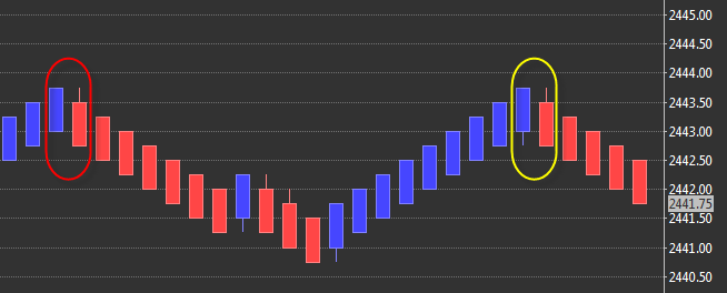

2garin - Posts: 189
On Renko bars you can define the body of the bar separately and separately the shadows?
How to identify the Renco bar with shadow and no shadow?
Illustration 33: How to determine the condition? (Red fragment)
How to exclude the condition? (Yellow fragment)
Is it possible to measure the size of the bar in ticks?
Date Time Of Last Edit: 2017-08-11 18:58:57

[2017-08-12 14:55:51]
Yes.
There are separate identifiers for simple alerts for the Renko Open and Close which draws the body of the bar.
Here is the relevant documentation for all of this:
Renko Bar Charts: Renko Open, High, Low, Close Values
Use these values for simple alerts:
ID0.SG22, ID0.SG23
If you want to calculate the range, just use the minus operator with these.
Use:
ABS(ID0.SG22 - ID0.SG23)/TICKSIZE
The above information is for Simple Alerts and not Spreadsheets. But the documentation we linked to explains how to access the same data with Spreadsheets.
Date Time Of Last Edit: 2017-08-12 14:58:05

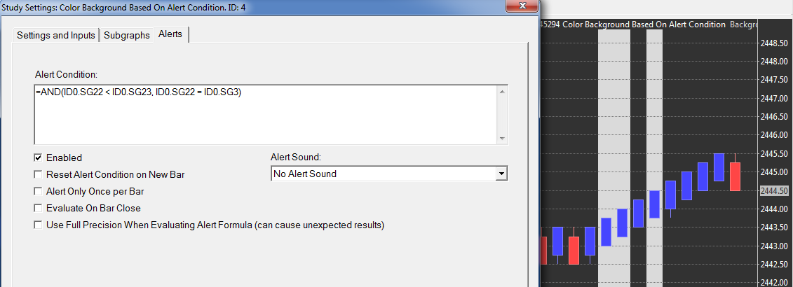

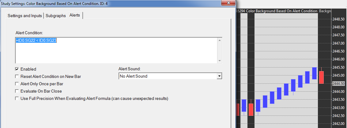

2garin - Posts: 189
How from the sequence of blue bars (Renko) exclude bars with shadows?
image3.png / V - Attached On 2017-08-12 18:45:33 UTC - Size: 40.31 KB - 485 views
image4.png / V - Attached On 2017-08-12 18:45:42 UTC - Size: 40.24 KB - 486 views
