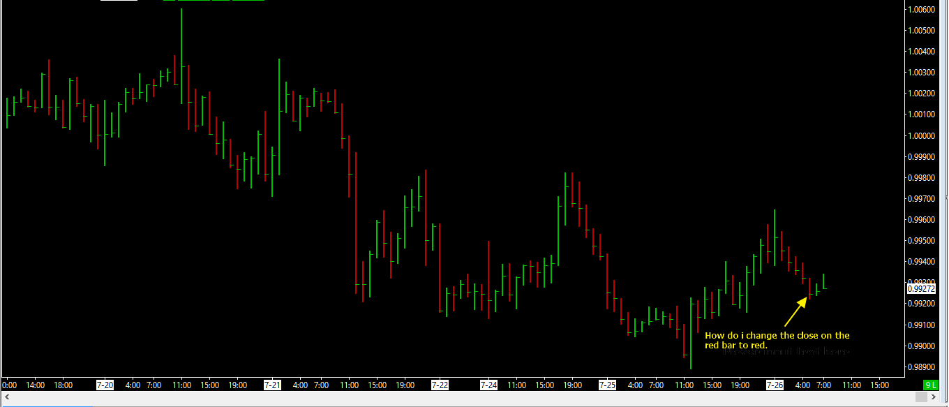

Hi i am currently using the sierra software, and i am using the HLC bar with the up bar green and the down bar red, now if i change the color of the close to green it is fine for the up bar, but it is showing green on the down bar is there anywhere where i can change the close of the green bar to red?? attached file thanks.
imageImage 1.png / V - Attached On 2017-07-26 05:23:29 UTC - Size: 19.71 KB - 378 views

You need to enable the setting for this:
Graphics Settings: Color Entire OHLC Bar the High/Low Color
