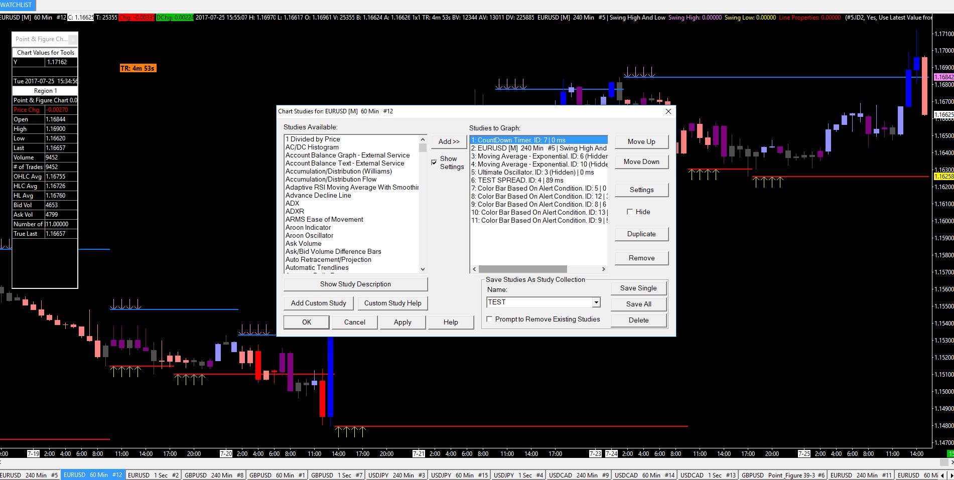

I also use spreadsheet study.I have tried all possible combinations in the "Studies to Graph" list but I still have to open settings then "ok" to repaint the study on the chart. Is my order of calculation precedence right? Please see attached.

What is the exact name of the Study Overlay study? And what is it overlaying?

I have a Swing High and Low on a 4hr Chart. I then overlay it on a 1hr chart. However, I also have a spreadsheet study that draws the overlaid Swing High and low study as dashes.

Could you provide us the Chartbook, with just the #5 and #12 charts.

We have simplified your Chartbook to two charts and just 2 studies and we cannot see any problem with overlaying the Swing High and Low study during a chart replay using the Study/Price Overlay study. It works properly and with complete consistency.
There are no changes after a recalculate.
The Chartbook is attached.
So if there is a problem, we need step-by-step instructions to reproduce. And it needs to be a simple example.
