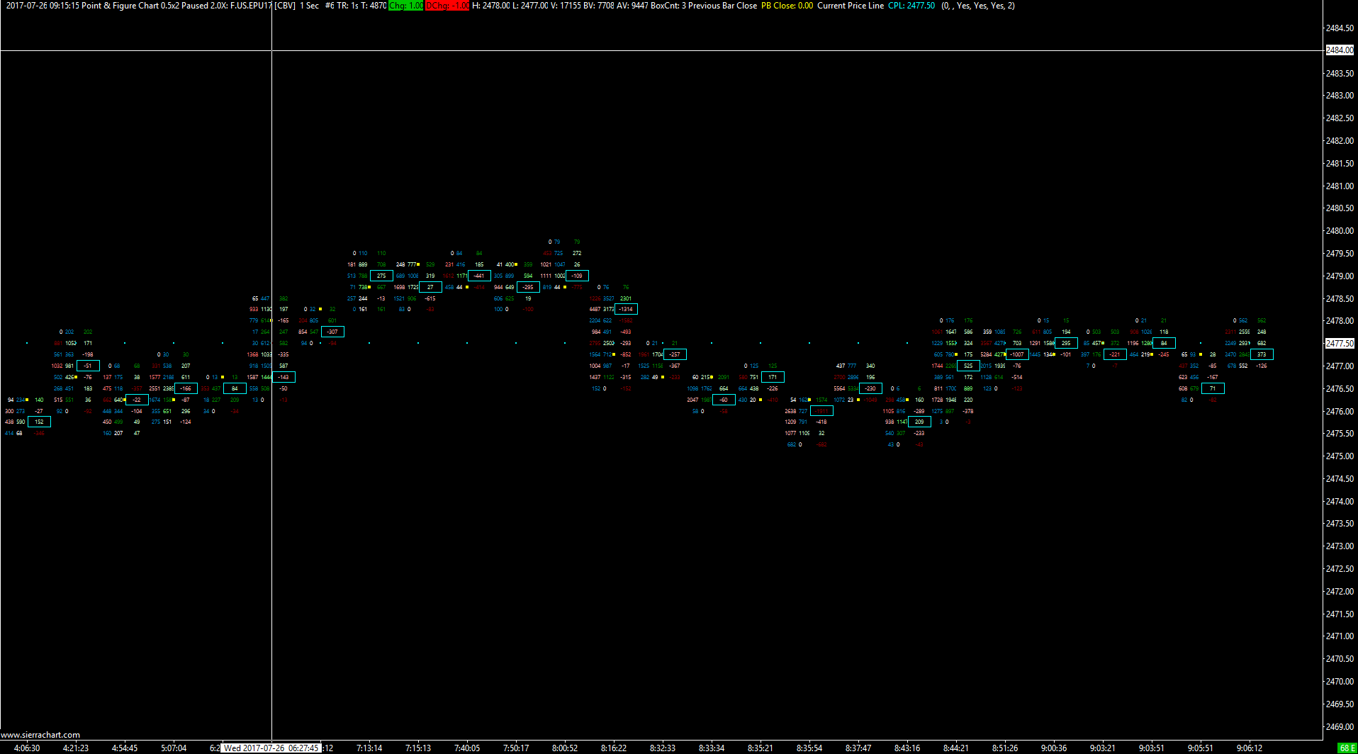

User884307 - Posts: 173
Hi
Further to your post yesterday, please find the 1583 version screenshot of what the prints have always looked like and then the screenshot of what it looks like post 1583.
In the post 1583 versions the print flash on, then off and either come back on or disappear completely?

[2017-07-26 10:32:40]
These are both taken at the EXACT same time :-)
ok I have uploaded the chart via the edit menu etc. the link to chart also is : http://www.sierrachart.com/image.php?Image=1501098149670.png
Please not this is using version 1583 that works so obviously the bug is not present in this version
Thanks :-)
