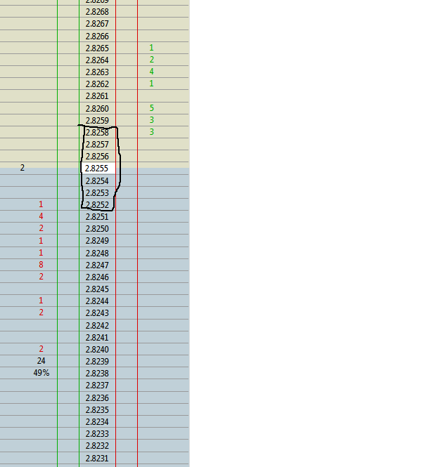

User22396 - Posts: 191
give the ability to put a box around it as per my older thread ganz referenced above...
i reposted the image below
Date Time Of Last Edit: 2013-09-05 21:18:08
