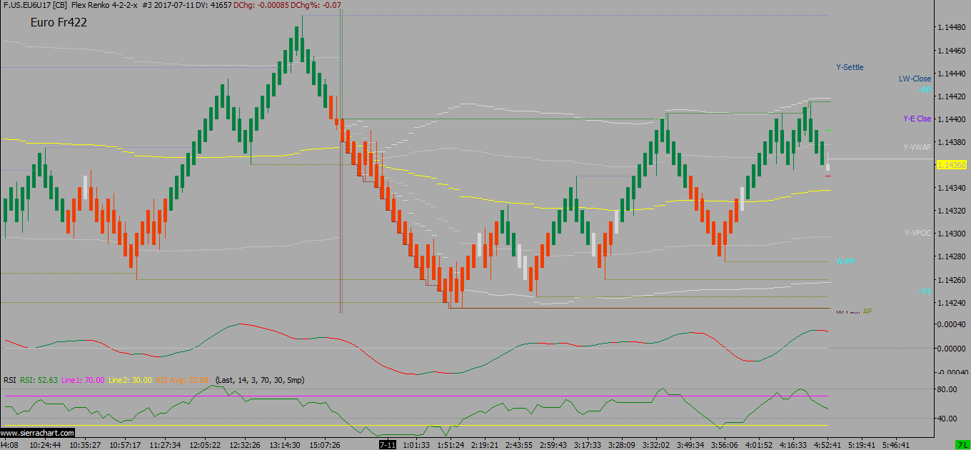

Both the attached images were captured approx 4:50am 11 July USA ET and are of the same place on the Euro (6E).
The file with v1570 in file name is correct with 3 instances of the Color Bar Based on Alert correctly fully painting the price bars Red, Green or Neutral.
However installing v1571 or later results in large instances of the underlying price bar colouring showing through and the Color Bar Based on Alert study painting the bars at best intermittently. (see file attached with v1571 in the file name).
I have tried this on W7 and W10 and with different chart books.
I cannot tell from the change log what happened from V1570 to v1571. I have been running this study in this format for over a year now on numerous earlier versions of SC.
imageF.US.EU6U17 [CB] Flex Renko_v1570_4-2-2-x #3 2017-07-11 0.png / V - Attached On 2017-07-11 09:10:04 UTC - Size: 43.33 KB - 373 views
imageF.US.EU6U17 [CB] Flex Renko #3_ v1571_2017-07-11 04_51_.png / V - Attached On 2017-07-11 09:10:13 UTC - Size: 51.88 KB - 436 views

It seems something in the SC software has changed in v1571 and above that is impacting the painting of the bars in this study.

I think it is something that has changed in v1571 to affect the Study in combination with Flex Renko bars .... because I just changed the bar type/period to 5 Minutes and it paints perfectly.
[2017-07-11 19:54:43]
OK we understand the reason why there is a problem now.
This will be resolved in the next release coming out today or tomorrow.
